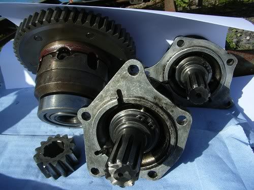

With your Salisbury, are the output shafts held in by circlips inside the output shaft bearing flanges ?. I can't think of any other way to hold them in place.
You are correct. Here's a photo I pinched off the net.
I'm not sure what Len used for output shafts but I would imagine it would be a similar setup. Mini spares list the output shafts http://www.minispares.com/Product.aspx?ty=pb&pid=32692&title=OUTPUT%20SHAFT which fit the Salisbury, but I don't know if they fit the Banjo. I know the Banjo came in course and fine spline, but these output shafts would be closer to the Banjo course spline.

Ahh, the photo explains it all. Thanks. Looks like some more time in the shed for me.
