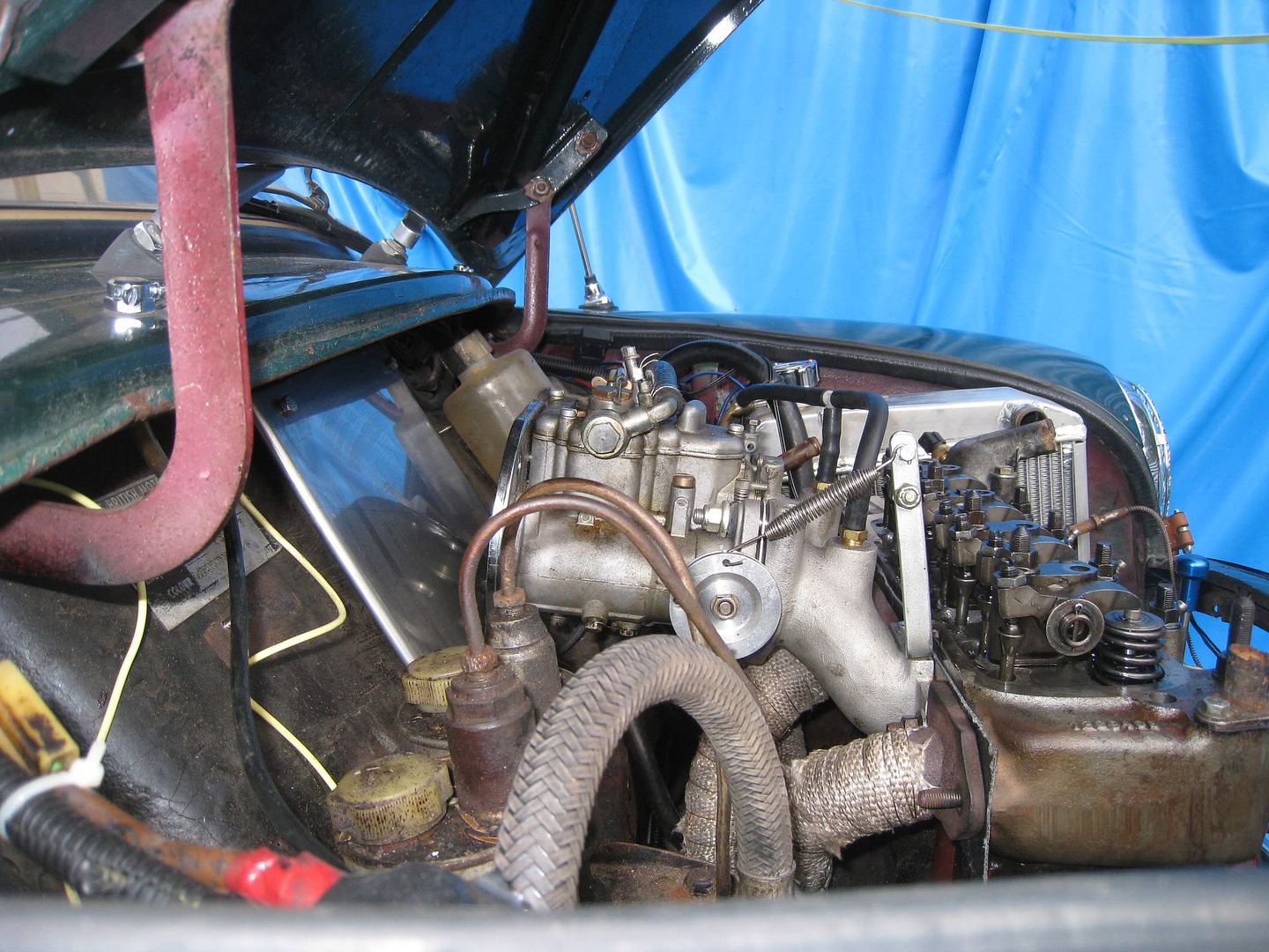

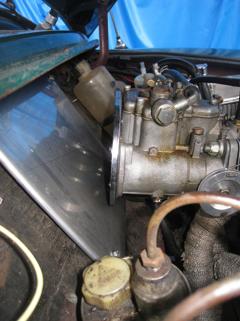

Ahh weekend, got some time to take some pics of where I am at:
2008 Prado GXL
PostPosted: Fri Feb 25, 2011 6:50 pm
Posts: 3398
Location: Quakers Hill Sydney
Not sure this would grant you enough room (not sure what filters you plan on running)
But could you bolt your firewall hole cover from the inside?
It looks like a terribly heavy guage of steel, could gain a few precious millimeters by bolting it from the inside..
You're so square
Baby I don't care
PostPosted: Fri Feb 25, 2011 7:19 pm
Posts: 6858
Common sight. See the manifold flanges touching the carb? and the flange that touches the head. Those two can be machined so that the carb angles up slightly, slight enough to clear the ramflo.
Also there are several offsets of Ramflos. You want a RF 445P1S I think where P1 designates that the carb plate face is offset downwards slightly, meaning that the throttle holes are at the bottom of the plate rather than the middle. This gives you more room.
But yeah even with all of this we are talking mm of clearance and I remember having to use BFH surgery to create clearance.
As said, after awhile I just got fed up and put in a box. Hassle free now!
Lillee - 1969 Morris Mini K
PostPosted: Fri Feb 25, 2011 7:47 pm
Nope he needs a R445 P5S Ramflo, not a P1S... :wink: But the pic looks like it is one already.
When I previously screwed some colorbond steel onto my firewall, I did belt a dish into it at the bottom for more room.
Why not fit an early Clubby cover plate, they are dished already for clearance. Chrome the bugger if you must. :P
