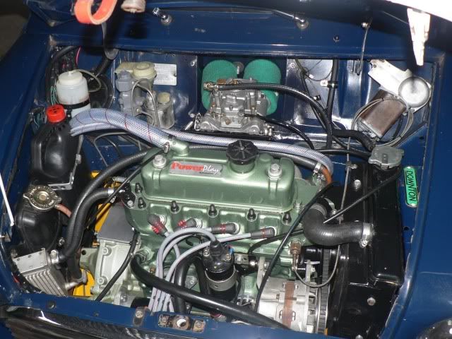

Hi just saw a good clean example of air box for long weber manifold on davem's thread viewtopic.php?f=2&t=87955
and wondered, does anyone make them as a unit.... or have plans already made...
i know i can just use the CAMS info and make up a cardboard box pattern to start, but i was struck at how tidy the one in the photo looked
Cheers Darryl

it does look very tidy im also keen on this information.

contact greg at mini classic, he has a guy who does his fab work, very nice quality, not to expensive either. Very excited today i should be picking up a order for the clubbie at DHL from KAD and carbon weezel this arvo, if all goes to plan!

On a previous car for my Weber box, I just used a battery box from a boot section and modified it. It's a bit ghetto, but worked fine. I'll see if I can find some photos.
For my current car I'm pretty sure I bought a prefabbed weber box, but buggered if I know where from. Probably from eBay, I found this one but I'm sure I didn't pay that much... On the upside, it has the dimensions in the advert :)

If fitting a Weber box, don't make it too small.
One member here got one put in, and it cleared the short K&N Weber filter OK. But, this filter didn't flow enough air for the motor (with 120HP at the crank). He didn't want a Ramflo on there, so he was stuck with using 2x Unifilter socks.
[edit] manifold was an RE5".
