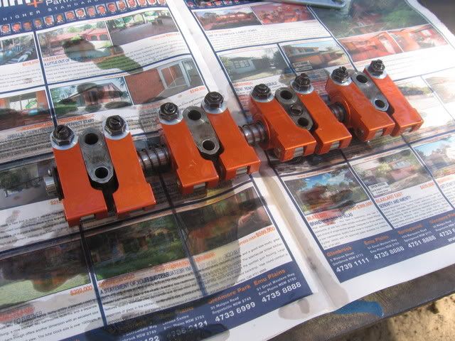

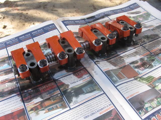

I had a set of Minispares break. Not impressed, was an expensive rebuild.
Bought a set from Leigh Engineering in Heidelberg. Beautiful piece of work. Have been on for several meetings how. Any engineering business with an Nb Mini on display gets a tick from me.

FNQ wrote:
36 they do look the goods, what size rocker shaft is that or is it the spacers that make it seem larger?
The spacers make it look large. It's a normal sized shaft.

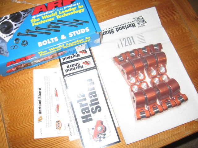

PostPosted: Tue Mar 18, 2014 5:46 pm
Posts: 39752
Harland Sharp do 1.5s for A series too. But you have to supply your own offset rocker posts.
http://www.harlandsharp.com/948_1275_mgb.htm
Dunno how well made Harland Sharps are, some blokes on LS1 forum have bagged them.

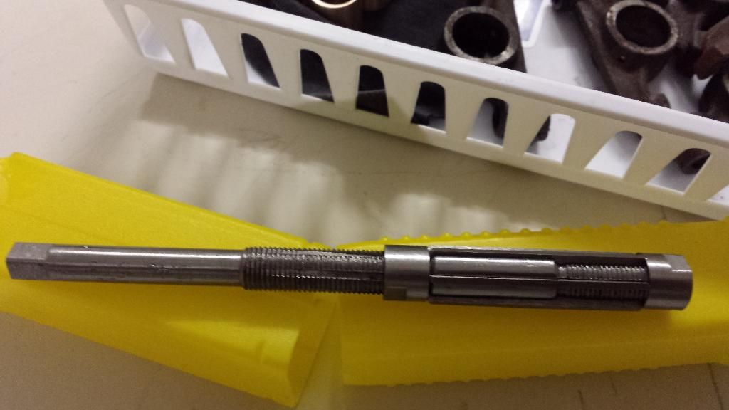

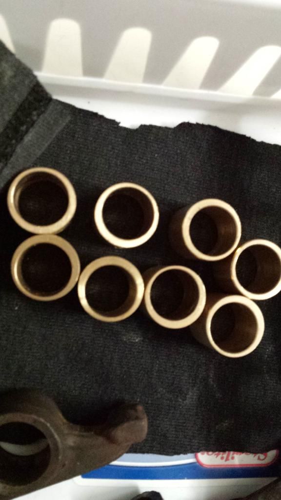

Found them. Offset bushes. And I picked up an Adjustable Reamer to suit the rocker shaft size, H5.

Lovely looking bushings. How do you line them up?
Behold! The mighty 850!
PostPosted: Fri Mar 21, 2014 6:59 am
I haven't tried fitting them, they've been waiting for a good reason to need them :lol: but I did another set a number of years ago using a socket as a press and a vice to apply the pressure with a set of soft jaws.
There's no reference mark, but you are supposed to press the thick side of the bush in towards the valve contact pad.
Consistency would be the trick here.
I'll sit down and work out a method which gives some accuracy, but if the rockers somehow give varied results with a standard bush alone, it may not amount to much in the outcome
