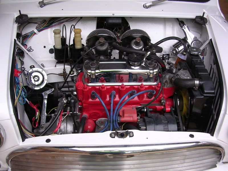

well mine is small bore and mine has a 2.76. but it doesnt struggle and sits on 100km/h at about 3000rpm Image

It would take a special small block to go up hills as easily as you are saying..
My engine is 1152cc, 12G295 Head, Electronic Distributor, Lightened Flywheel, RE-13 Cam, 40mm Dellorto on a 5" redline manifold and it makes about 45-50HP at the wheels (about the same as a cooper S makes - so 75HP)
Out of three dyno days so far, no small block has cracked over 50HP.
So we can establish that 50HP is a fairly hight state of tune that one could reasonably expect from a modified small block. With that much power I struggle up hills in 4th, and to get that much power out of a small block you need a wild cam which wont come on song until at least 3000rpm.
Now there are very special small blocks out there making 90HP+ ie. GR's Small Block project, but this is not the norm.
I'm not saying your engine doesn't, but i'm skeptical and would like to see a dyno graph of the power it's making cause you'd need some serious power to put your foot down 'slightly' to go up hills, especially with a 2.76fd

yes i no that my car has a 2.76 because i put it in and i no my car has quiet a bit of power. the hills im talking about arnt mountains but if u have ever driven into sydney from gosford my car didnt drop any speed from 100 at anytime on the freeway. my 1100
is bored 60thou lightened and balanced bottom end a 12g295 head ported and polished head with big valves, cooper s police spec cam, roller rockers, electronic ignition, 10.1 compression, extractors with 2 inch free flow exhaust. anyone that wants to have a turn in thr car is quiet welcome i want to justify what ive been saying. it isnt a bullet of the line but it is so nice cruising along at a hundred and being able to talk to the passenger. lol :D :D :D
