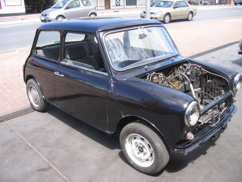

Thought I'd post some pics of my setup - not as clean as the fist pic in the thread, but it is a work in progress...

Yeah that's from previous owner not running coolant and the factory overflow pipe blowing rusty water every where. Nice and full now with green coolant, and functioning overflow bottle. No worries at all. The white powder on my temp sender is from when I installed it the other day - need to do a cable tidy up as you've probably noticed. Will get to car lovers one day and give it a hose down....
Temps are good - 180F around town 200F on hwy @ 120km/h 30 degrees c ambient. Should have gained a couple of hp too not having to drive the mech fan....
