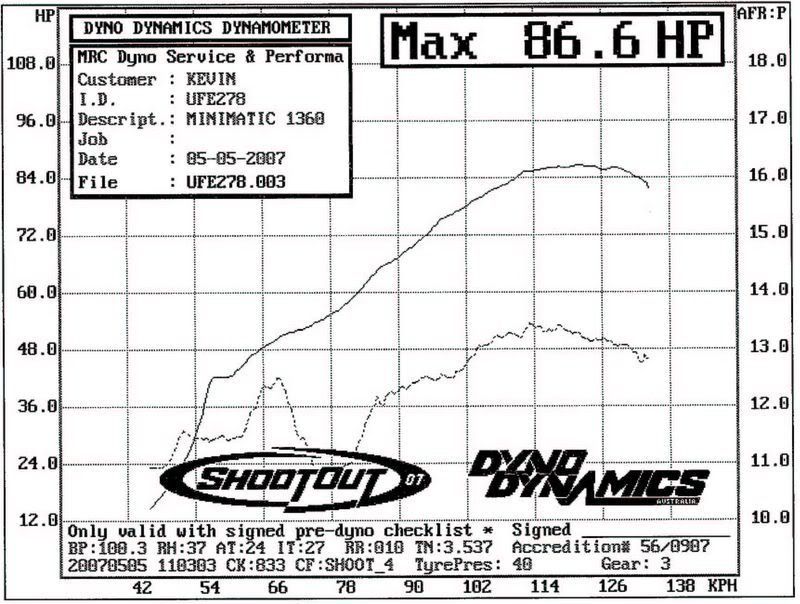

At last years' dyno run my 1360 got 86.6HP ATW, same engine except cam changed (now RE282) and a 2" exhaust system. Over 11HP gain at the wheels.
Dizzy is still a Nissan Pulsar D4R85 (Hitachi), now with 9° advance plate.

hiya testing if this works:
first time build.. still pretty.
a go faster exhaust port
a few pics from the rebuild and a dyno plot that is not too pretty
custom bent pushrods
the cam can eat yer rodbolts.. kudos to the heat treatment ..the damage is minimal..but still
note the AF mix going haywire at higher rpm.
