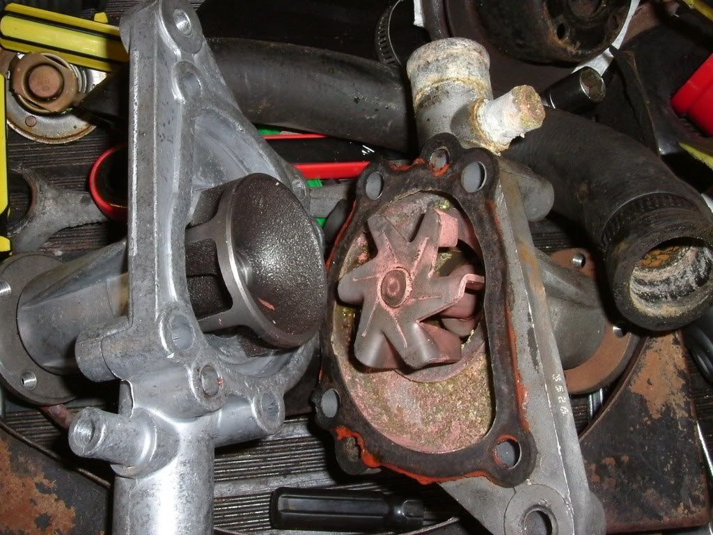

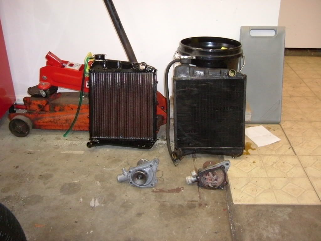

No wonder the poor thing was running a tad warm !!!
massive cores... :shock:
Hi flow vs no flow.... :wink:
hi flow pump on and new thermostat in.
Doh! why didn't someone tell me the fan was in the wrong way !!!! :oops:
Any way, now that i've figgered out how to post pics,(i hope ! ), I will post some more of the extra radiator I put in last week...

PostPosted: Sun Mar 18, 2007 8:23 pm
Posts: 1084
Great pics, your old water pump with the pressed metal style of impellar just don't work.
And sorry to say, looks like your fan is on backwards :(

PostPosted: Sun Mar 18, 2007 9:28 pm
The Forkmeister
Posts: 1029
Location: camden
I was careful to put the fan back on the same way I took it off, but than found out that the idiot that owned it before me had been driving it around for god knows how long with it in the wrong way !!! :roll: , so I had to remove and re-install all over again.... oh well, at least I'm good at it now. :wink:
