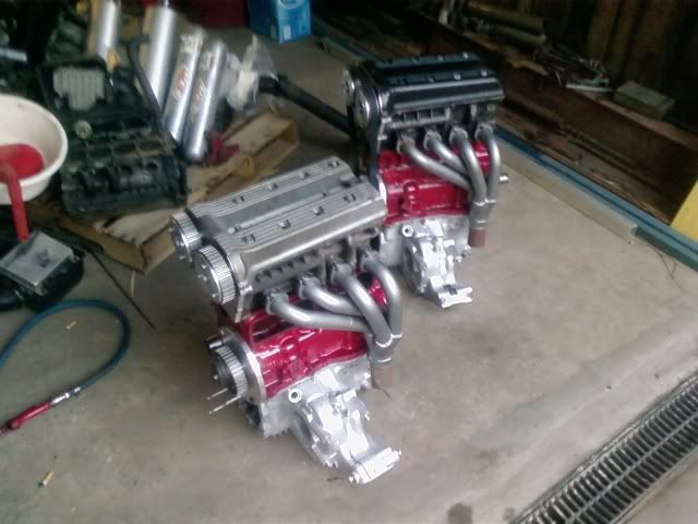

some stuff we make for the Twinkys
http://i376.photobucket.com/albums/oo201/madmatttheminiman/Photo0005.jpg
& a couple of Twinky donks,,, one 8v & one 16v
http://i376.photobucket.com/albums/oo201/madmatttheminiman/Photo0320.jpg
