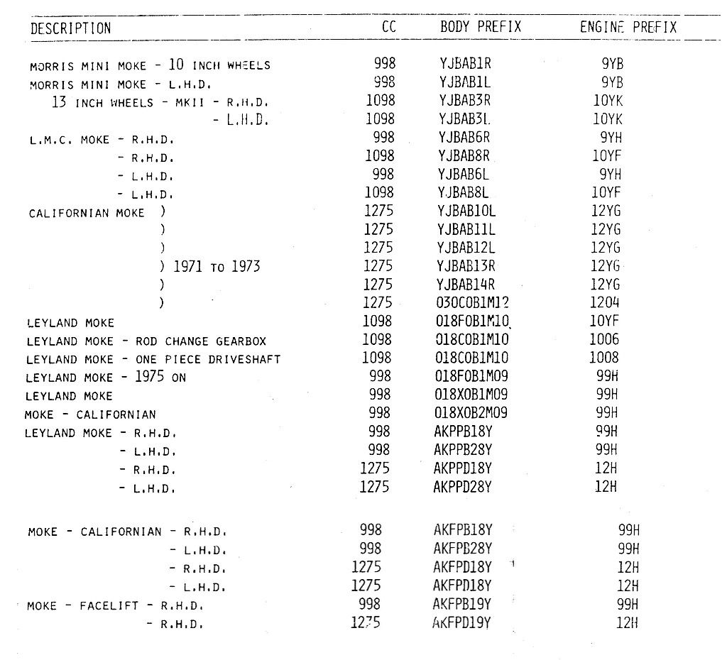

This is from the JRA Moke parts microfiche dated June 1984.
PostPosted: Sun Jul 13, 2014 3:12 pm
Quite a few variations on that list that I bet were never made!
Pity that it only says 12Y on the late ones.

My Mini Car Clinic parts book (condensed version of the Mini King one?) says a 12H706 is a 1275GT (I assume UK) one with alternator, mech fuel pump & rodchange.
The Mini King Book just says the late? Moke 1275 motor is a 12H. Same as in Winabbey's chart above.

My moke i bought 18years ago when I was 12 years old (saved my paper run money) is AKFPD18Y/****** and the engine is 12Y/Ta/H. So from that list it doesnt have the original motor but it was a 1275 moke?
Yep, a 1275 Moke with an early Morris 1100S motor.
