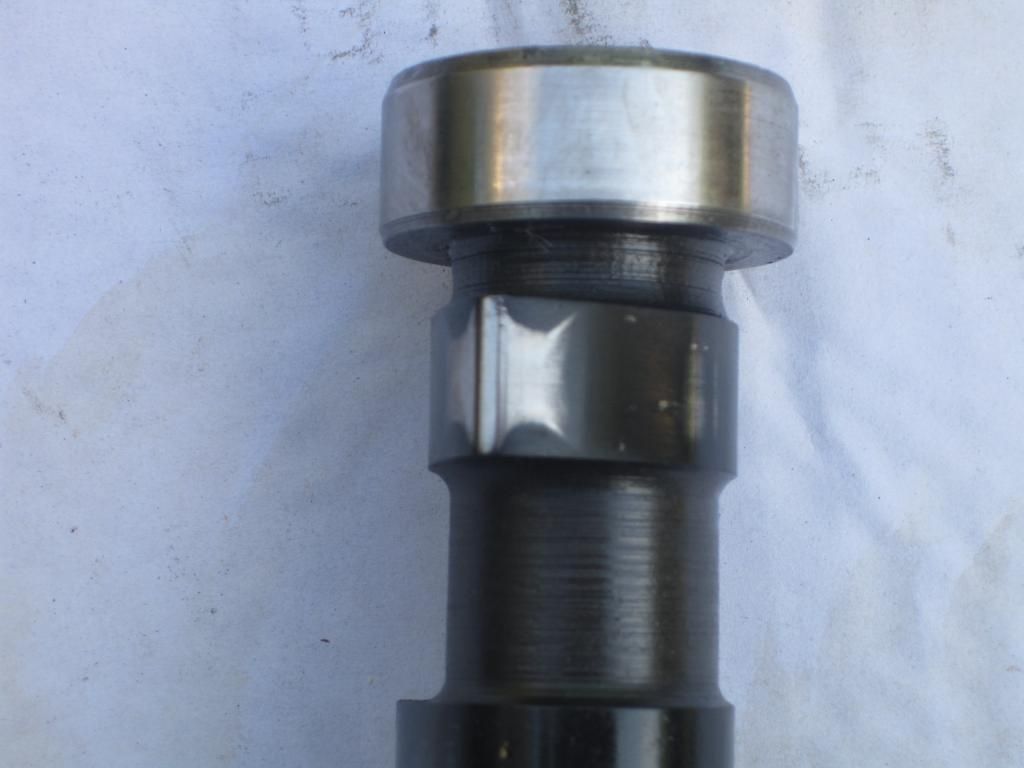

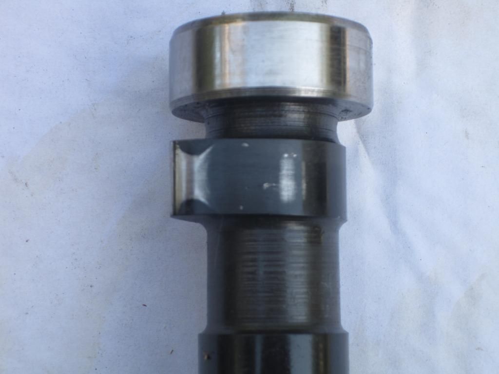

Hi All,
This is what I was referring to earlier. You can see how the follower was missing the flank altogether and hitting on top of the lobe, where normally you will see a line right around the cam to one side.
Note: The nose radius on this profile is under the recommended nose radius for a camshaft. This also makes it very hard on the followers as it doesn't carry enough oil to lubricate.
Graham Russell :D

OK fellas the problem is this - the plant that used to make the genuine followers for Rover and the ones MSC used to sell went out of business many years back now (Clancey's Limited). The tooling all got sold off or scrapped. There are no quality followers made in the UK now for push-rod engines. They are all made abroad by companies that do not have the technical capability, no-how, or machinery to make them to original spec. The followers they make are generally good except for the most important part - the follower face profile. This is not Mini Spares Centres fault as such - they are supplied followers from the importer. The importer and manufacturer have been told time and again what the problem is, with no solution, and more importantly no admission to the problem. So Graham (Russell) and I have taken steps to offer the beleaugured A-series users a real answer to the problem.
Cam manufacturers in the UK are no better than the follower manufacturers when it comes to decyphering cam/follower damage/failure. They just point the finger at each other to no benefit or solution to the users (us). The manufacturers are not interested because they sell the followers anyway. They are not looking to invest money in tooling or machinery to do it - even if they actually understood what the problem is. Since we need followers to be able to run the engines, a solution is needed. Graham and I now have that solution.
