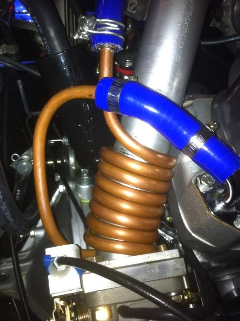

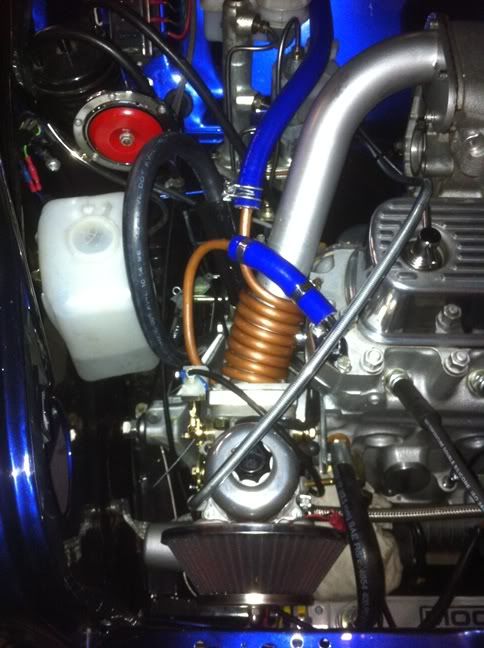

My latest modification to try and overcome the flooding while at idle.
It appears to have improved the stop start issue but it affected the power when trying to accelerate while driving back down the F3 when on the long hills it would seriously ping at any thing over 4000 rpm. I thought about it later and should have turned the heater off while on the freeway. Looks like another drive on the weekend to try out the theory. :wink:

PostPosted: Tue Jul 03, 2012 11:38 pm
just pull a bit of advance out of it
PostPosted: Wed Jul 04, 2012 2:36 pm
Posts: 533
michaelb wrote:
there's something missing from that picture...
An oil leak :?: :shock:

PostPosted: Wed Jul 04, 2012 5:46 pm
Posts: 3166
Hi Simon, already running about 15 deg of advance when under full power. I think the charge is now getting too hot due to the heater wrapped around he inlet and the fix is to reduce the heat, reduce the compression o reduce the advance. :wink:
My first plan is to reduce the heat and then reduce the spark advance if that doesnt help.
I am also tempted to try a thin decompression plate to see what difference that makes :?:

PostPosted: Wed Jul 04, 2012 7:27 pm
Try turning the heat off and see if that makes a difference. You will need to do a few runs to make doubly sure.
I would also try it without heat and blank off the grille in front of the carby.
PostPosted: Wed Jul 04, 2012 8:01 pm
