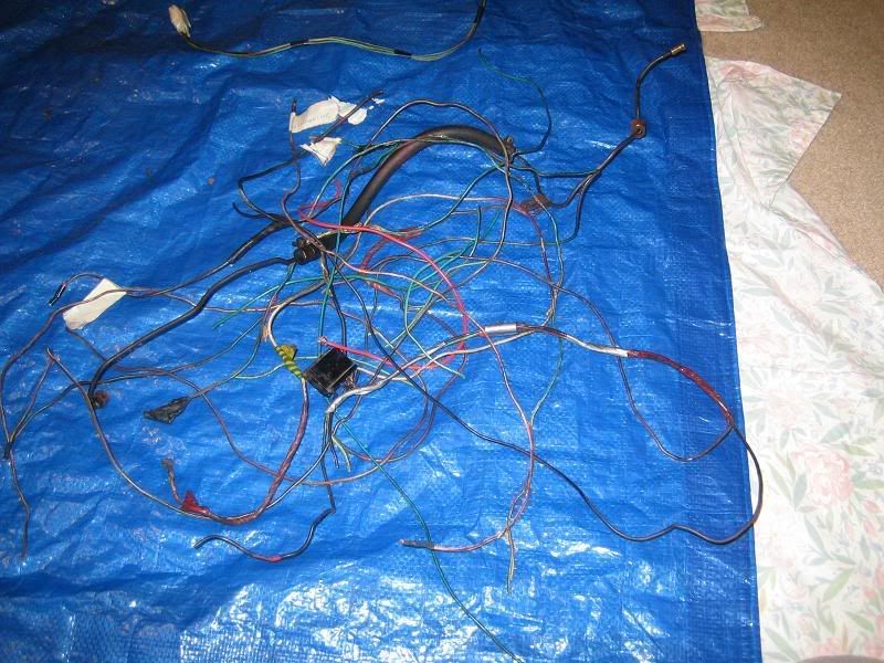

Wiring loom before :?
Wiring loom after!!!
What I removed/replaced from the wiring loom

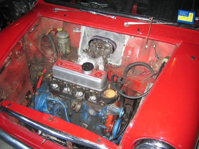

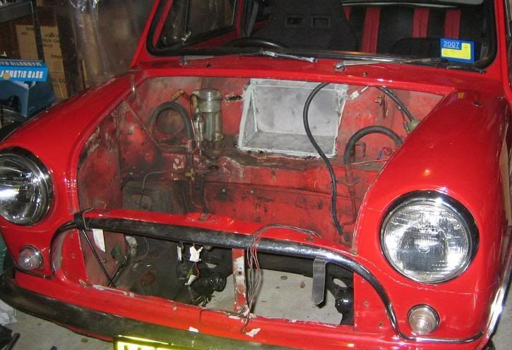

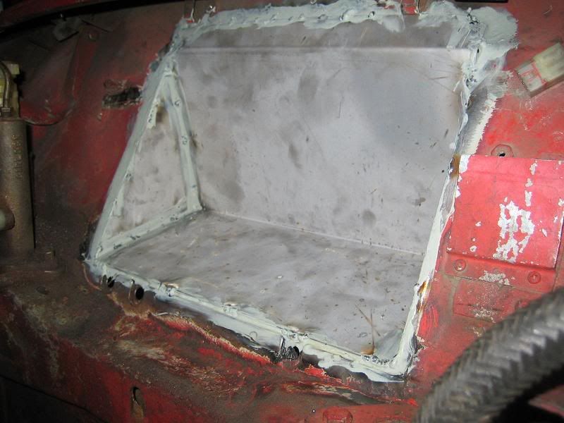

I also managed to get the weber box custom made and welded to the firewall!!! I towed her to Greig at Mini Classic Ermington ph:9874 7211. Looks great in person, should look even better once the engine bay is all stripped and painted.
Engine Bay Before box
Engine bay after box!!!
Here is the clearance and fit. Yes yes I am just resting the intake, dellorto and K&N filter on the box
It actually looks alot bigger in the pics than it is. I am very happy with the results. Thanks Greig!!!

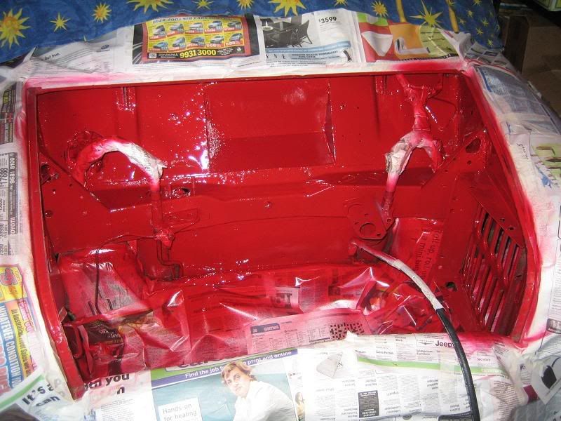

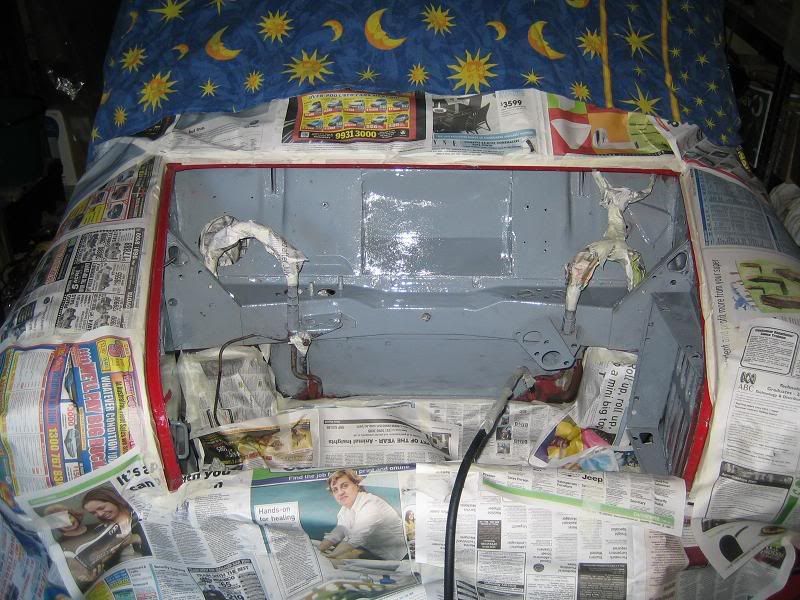

I must say, now I know why everyone goes on and on about POR15... It is truly remarkable stuff! I am thoroughly sold on it and recommend it to anyone doing this type of restoration work. 2 coats
After
Automotive enamel over the top. First coat. I must admit I have a few runs but all in all it aint bad considering it is my very first time using a spray gun, plus I could not work out the flow control until I was already half done :lol: :oops:
Sanding it back before the next coat should fix that no worries right? Not long to go!!! :D

PostPosted: Sun Dec 10, 2006 7:47 pm
Slowly getting there 8)
PostPosted: Sun Dec 10, 2006 8:08 pm
ausmini mod
ausmini mod
Posts: 1938
Location: Kellyville, NSW
Chong,
Sanding back should help yes BUT dont sand through to primer if you can help it...
Peter.
PostPosted: Sun Dec 10, 2006 8:51 pm
Painting the engine bay will make a huge improvement...Looks geat Chong
Did you use the marine clean and the metal ready also ?
also was the the POR 15 still tackey when you put a coat of colour on???

PostPosted: Mon Dec 11, 2006 6:20 am
Posts: 2292
Looks fantastic mate!!!! Good effort too for a first timer. Good luck with the 2nd coat, it'll look shmick once completed.
PostPosted: Mon Dec 11, 2006 7:51 am
Posts: 6858
Yeah I used the marine clean and metal prep to the exact instructions. The marine clean is good stuff even though you have to water it down 50% 50%. The metal prep made the rust go black which I think it's meant to do.
I'll wait a few days for it to dry properly before sanding it down doing the second coat.
I am very happy with the results, anything has got to be better than the top picture!
