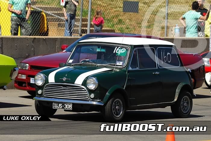

I went to Calder park for a drag with my mate just to get an idea of what kind of speed i could run. Had a hell of a time finding traction just couldnt get the power down was insane. ended up running a 17.42 , 17.323, and a 18.1 (cos i was in reverse when the light went green :evil: . after i do some work to the suspension ill go back and give it another go

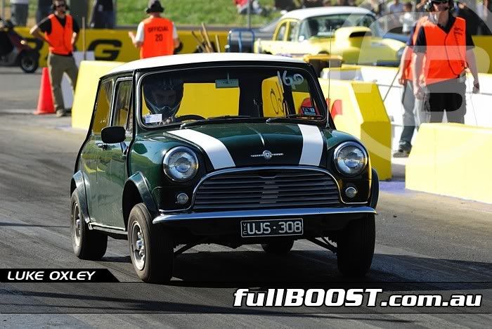

And thats why i lose all that traction

ahahah thats a wicked picture :D probably be a crap on the road but if you could make up some blocks that will go in place of the original rubber ones that reduce the droop on the front it would solve some of your issues..

That's an impressive amount of squat you have going there.
I have hydro on my Morris 1100, and as I don't have the option of fitting dry subframes, I started playing with the hydro a bit. I have a set of valves to fit in between so I can adjust the 'damping' orifice installed by the factory, but I can also close them off. Now I never tried these out as my last car was destroyed by my brother before I got the chance, but I will be re-installing the valves on the new one.
This is relevant to you because as well as being able to vary the orifice size, you could also close it off completely. So when you get ready to run down the quarter get a few mates to sit on the front of the car, fluid shifts to the rear, close off valves and you have an instant front-down stance for your run. Should help to minimise the weight shift which is causing you problems. I'm sure there are other things you could do as well, but this is one idea I had. I haven't tried it yet but I reckon it would help.
