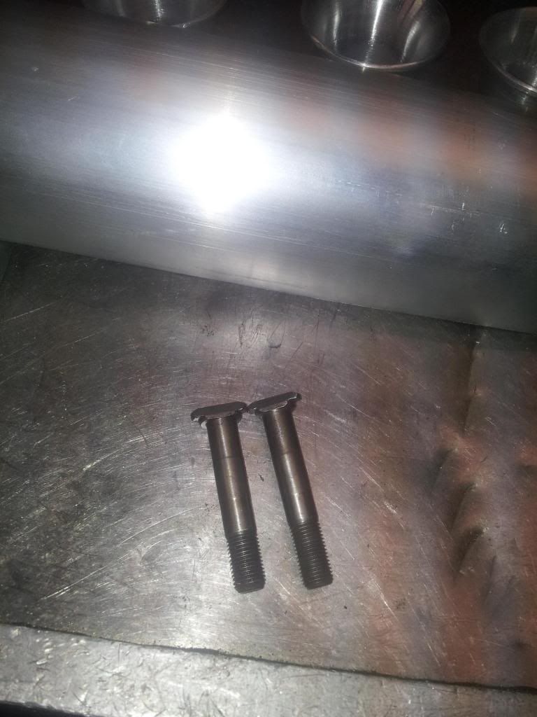

yep, Ty is right,,, i dont think i ever saw a set of 1772 in an 1100s donk
i believe the 177 rod-bolt is shorter & different shape
i have a set of those old things (rods) sitting down in the shed so i`ll go check right now to make sure,
edit--> back in a sec :-)
2nd edit-->
yep the 521 bolt is longer by a tad & the "thick" shank section is a little further down the bolt to suit also... the head is the same shape & size tho
177 bolt on left,,, 521 bolt on right

Wasn't the 177 S rod prone to break near the bolt heads? I seem to remember pics somewhere...
PostPosted: Fri Jul 26, 2013 4:42 pm
yeah they are a tad thin in that upper area on each side,,, & that`s in fact why the 521`s were made thicker in that area to help stop that "pulling-in" happening

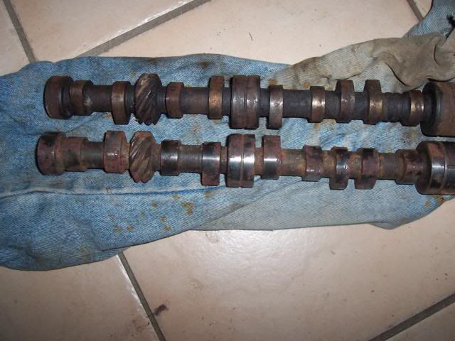

Cam selection;
These are two I found in my shed, I'm thinking the top one is a 998 or 1098 but I don't know what the other one is, any help?

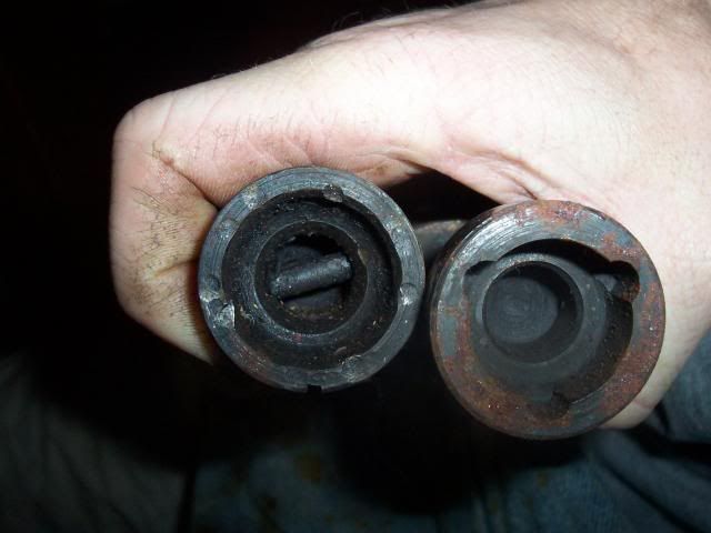

And the pump drives, (the one on the left is the top cam).
So I'm thinking I'll cut the one on the top, small lobe, spade drive cam down to use...or is it more inportant than I think?
And what is the other cam from?
Also how concerned do I have to be about overheating the cam when I'm cutting the lobes off with a grinder and then machining it all round in a layth?
And Finally, do I machine it down to the shaft diamiater or is it better/eaiser to just leave the "lobe" sections 1 or 2mm proud of the shaft?
PostPosted: Tue Aug 20, 2013 7:05 pm
I would just do the spider drive cam Kenno,,, it`s out of an 1100S block anyways so it fits your application & you can get an oil pump to suit it,,, all you need is the little spider drive piece to go with it & yo`ure done
&no problems grinding the big chunks off & then lathing the rest,,, that`s what i do mate , easy-peasy
If you chose the small-bore cam-shaft then you will struggle to get a pump to suit,,, & the adaptors that Dave makes for me to use with that application we make them out of 4140 & they`re awesome & we can use the small-bore pin-drive cam & still fit the late spade type oil pump & that`s all wonderful,,, but Dave is out of action having an opperation so he won`t be making anything for anyone for a while
so best to just use the spider drive cam ok

You can get the pin drive pump from what I can find http://www.minis.com.au/minis/catalog/p ... cts_id=194
And the spider drive pump http://www.minis.com.au/minis/catalog/p ... cts_id=195 but I don't have the spider drive gear :( .
So they are the same price, is their a difference in volume or strength? Also their seems to be just as much or more options via the minisport site http://www.minisport.com.au/category22_1.htm
Should I be looking at the metro turbo high volume pumps or are all the other small bore and 1275 pumps up to the job.

Also my engine is a 1100S (12YD/Ta/H) from what Matt mentioned about the 1100S cam fitting straight into my block, is there a difference in cam sizes or lengths or bearing locations?
I'm just a little bit hesitant about cutting down/using the 1100S crank because I only have one of them but I have half a dozen small bore cams. Plus I would like to use the 1100S cam in another 1275 I have in the shed.
PostPosted: Sun Aug 25, 2013 7:03 pm
Posts: 39764
Cams and blocks are all the same length.
People think Vizard said different, but read what he said again.
The pump recess in the block is not as deep on a 1275 (except autos) that's why the Cooper S pump had a longer shaft in it.
I have had spiders made to fit your cam to a 1275A+ slot drive pump. PM me if you want one, but I think Matt has some there already?
You can also TIG weld these spiders (after turning down) into a pin drive cam, I have done a few like this.
PostPosted: Thu Sep 12, 2013 12:53 pm
Yeah Kenno,,, the Doc nailed it (yet again)
that small-bore oil pump you linked to isn`t the right pump for you,,, youi would need an "S" (12175) pin drive pump with the longer shaft & the more robust body,,, but they are a bit hard to find... & you would have to drill & tap the block for the right bolt location of the upper middle bolt to fit.
so,,, you have basically 2 options if u fit the small bore cam->
one: is to use the 4140 adaptor that we have made to suit the pin drive cam + spade drive pump slip it in when fitting the pump & Bob`s your aunty :-)
or grind down & then weld into the pin-drive cam the adaptors that Kev made for the spider drive cam to fit the spade drive pump,,, & yes i have plenty of those here still (cheers Kev)
