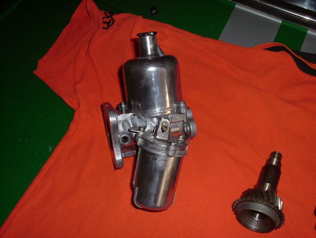

Anyway I got some other stuff for the build, 1.75 su and some very nice gears from John during the week,
Cheers Gerg

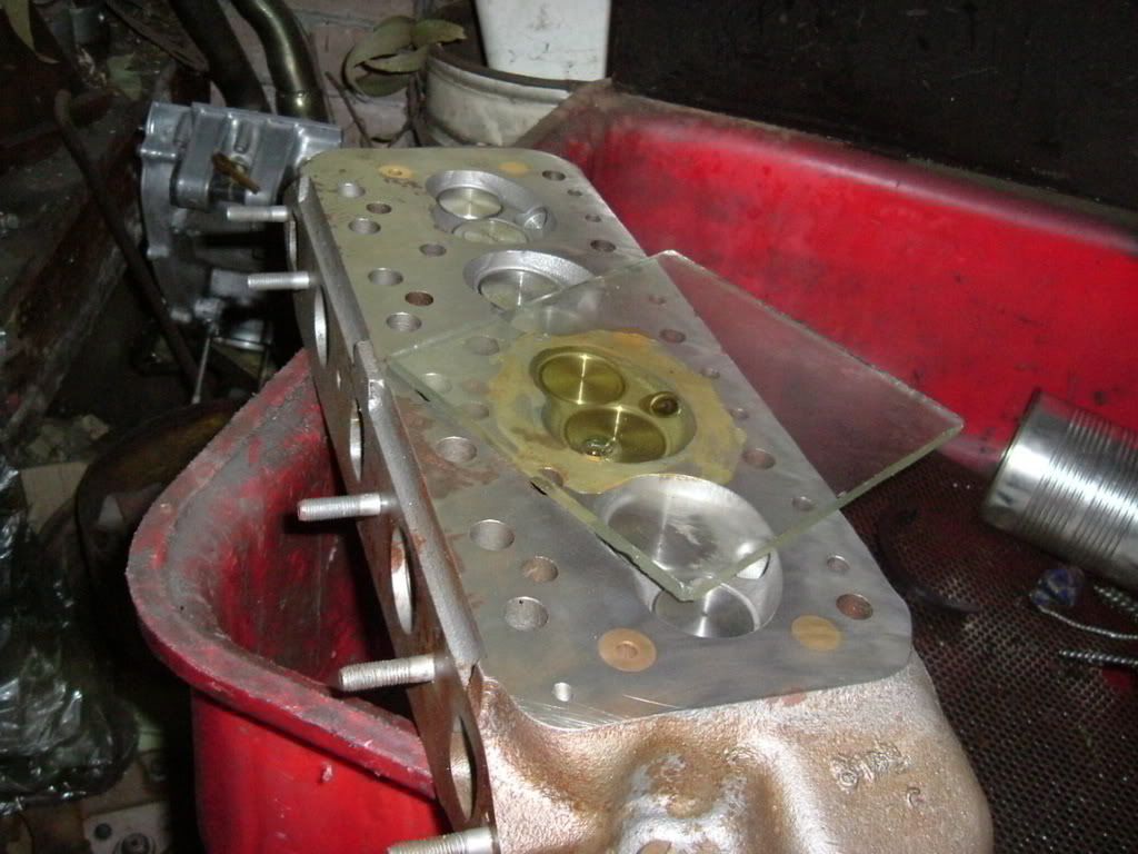

Took a trip over to see GR on Saturday to have the head cc'ed and see how he is going with my motor, so far the block is bored,the bottom end balanced and the cam ground, he's just got to finish the manifold and put the whole lot together... :D .Anyway I got a couple of pics of Graham cc'ing the head,(it turned out to be 22cc) .

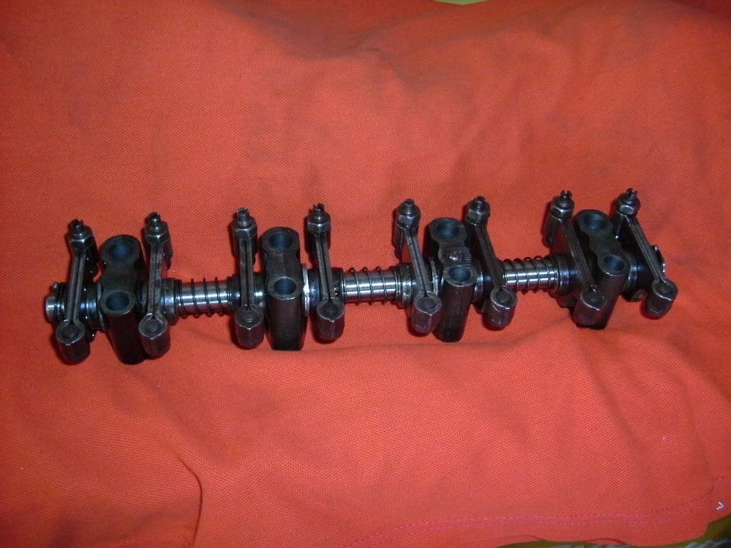

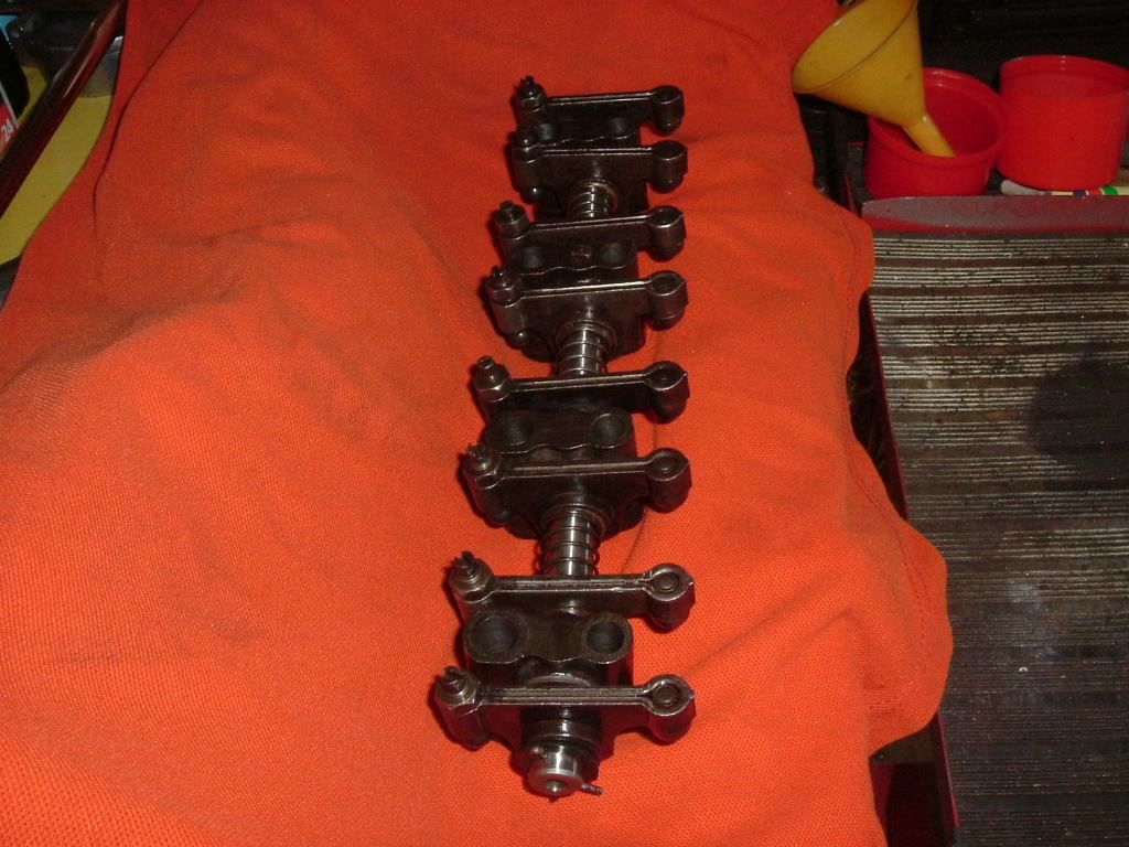

Hi all, just a quick update, got over to Kev's today and picked up my modified rockers( now their 1.3 ratio :D ), they look the goods ,thanks Kev. I spent the rest of the day cleaning the garage so I can get started on the clubby next weekend,(about time too!), now just waiting for GR to finish and I will be a happy chappy :D

Here's one of these rockers, shaft hole in bush is bored offset .044" after assembly.
Actual valve lift with an RE13 cam and .016" clearance is 0.365".

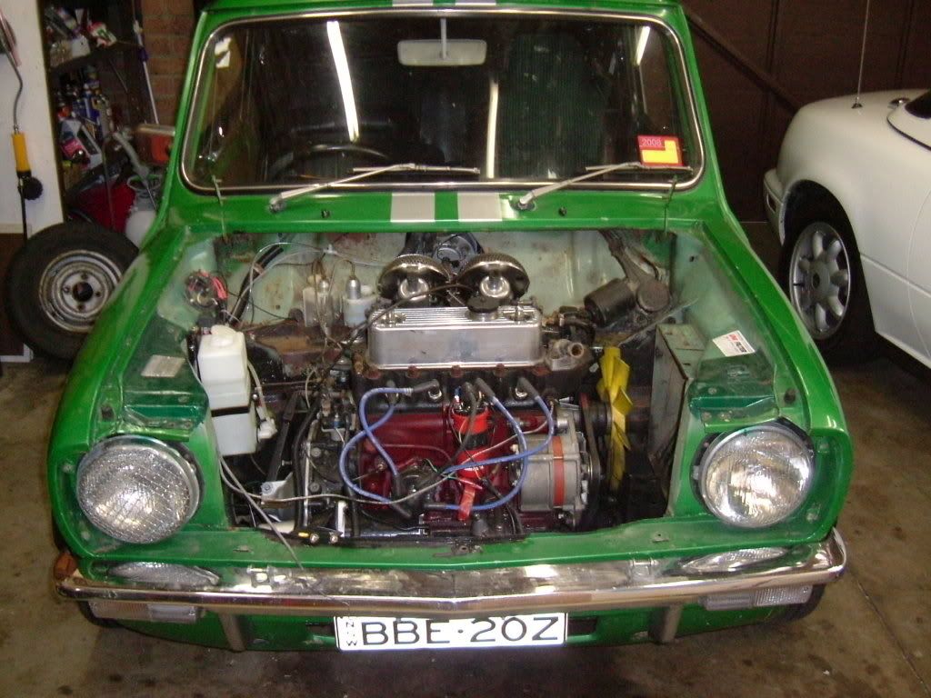

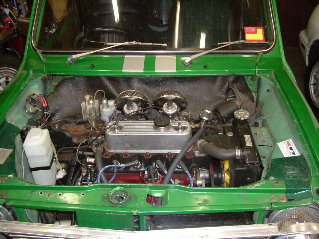

Well, here we go, I got all motivated after watching Kev's motor on the dyno yesterday so I finally got started getting the old motor out. My plan is to get the motor and subframe out next weekend and spend the next 3 or 4 weekends repainting the engine bay and reconditioning the front streering and suspension, hopefully by the time I'm finished this GR will have my motor done and Glen at the mini king will have my gearbox finished. :D, I'll have to keep my fingers crossed that it all goes smoothly so I can get him back on the road by the end on Jan.
Here's the start
And this is a couple of hours later,(with a few cold ones to help me concentrate :wink: )
Thank god for the guy who disigned the clubby front end.. 8) , and that will do for today, it's to hot, I have a date with a big screen TV and aircon..... :D
