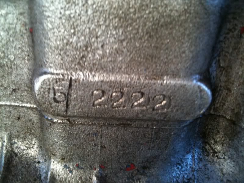

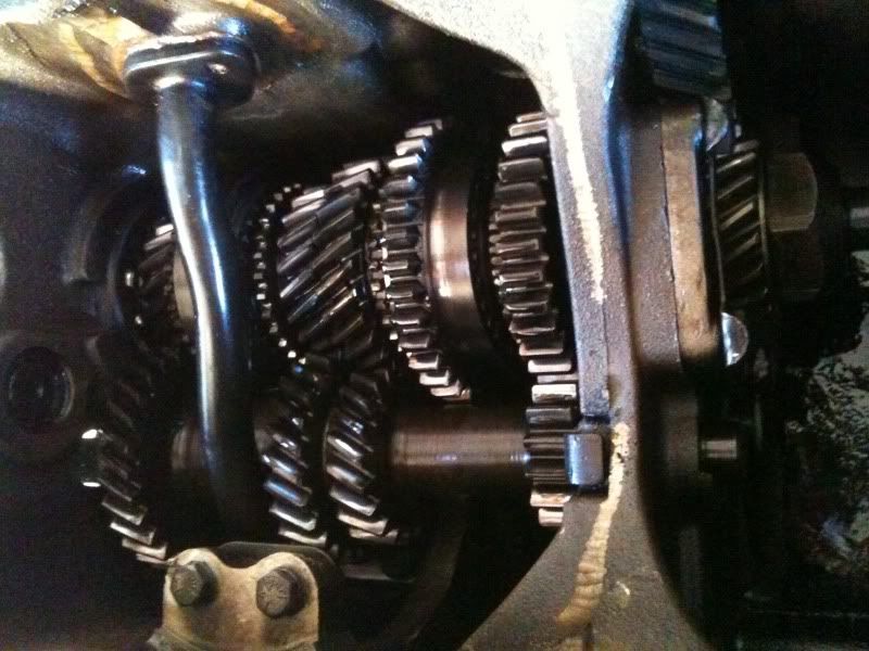

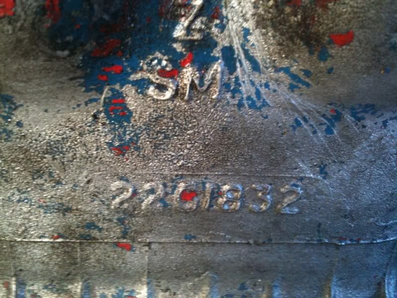

heres my gearbox, im assuming its a 4 syncro but someone correct me if im wrong because im about to spend a thousand bucks on straight ut goodies :wink: im putting straight cut gears in under the impression that 170ish hp is pushing standard gears to the limit.. is that true? i dont want to spend money on them and not need them, although i like the sound
PostPosted: Sat Jul 09, 2011 5:52 pm
Posts: 39764
Yeah it's a 4 synchro rod change, small idler gear bearings, NOT A+.
Be aware that 1st gear particularly will be pretty tall taking off uphill, so watch what diff ratio you use... :wink:
