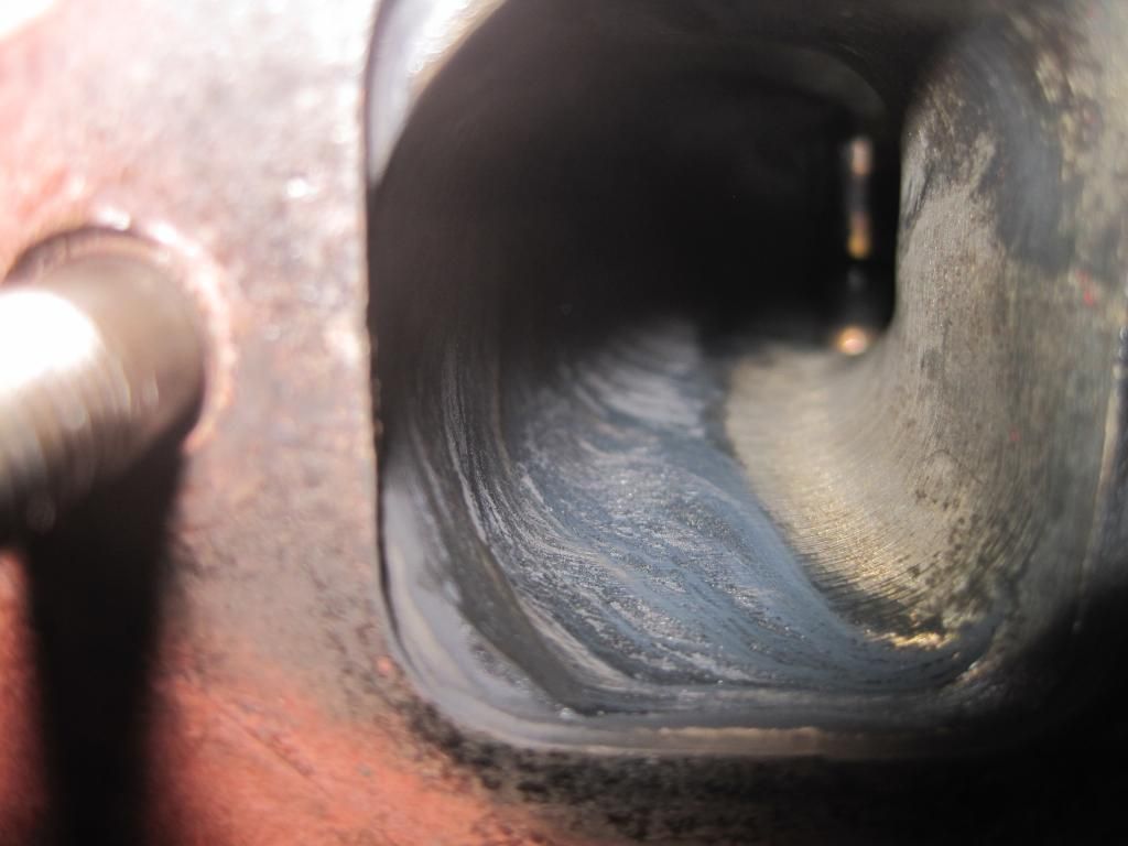

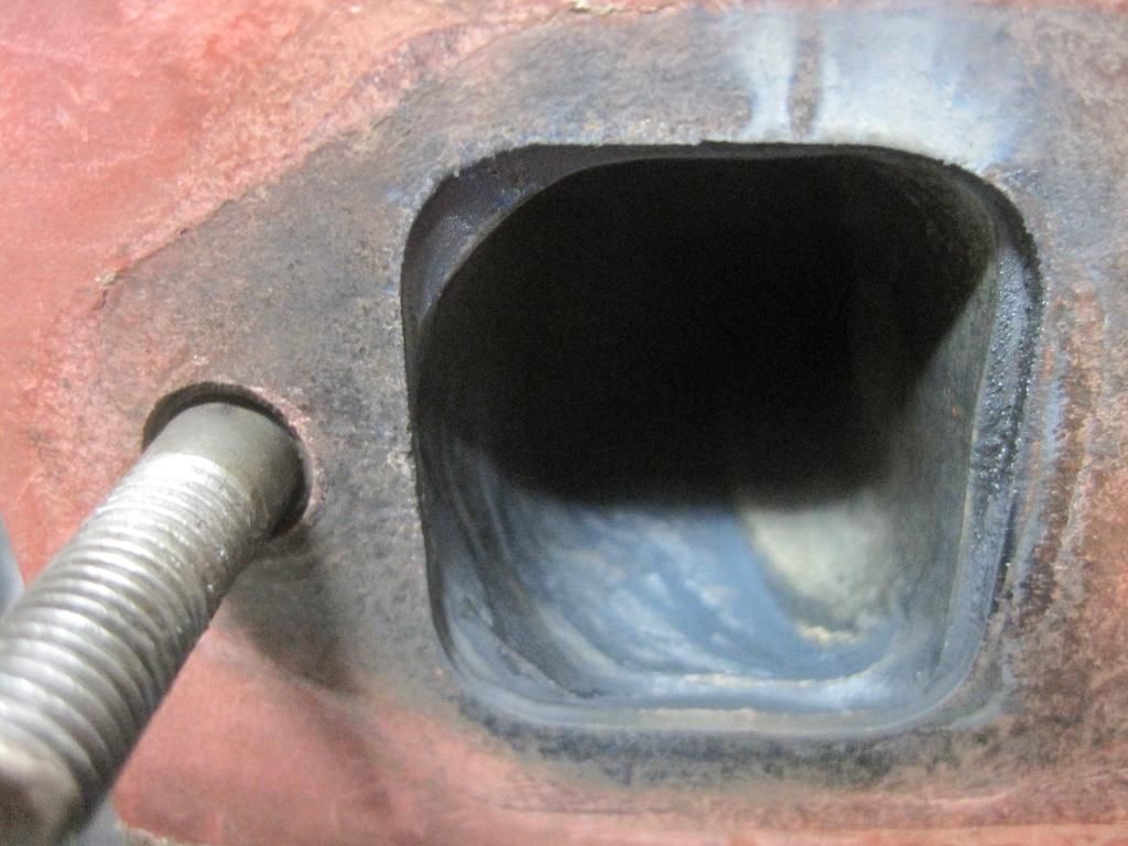

MG Rocket wrote:
Hi GR, I notice the end exhaust ports are D shaped. In my imagination I've thought that would be a good idea
and this is the first time I've seen it......What's your take on it?
Hi MG Rocket,
Sorry I didn't answer your post before this(The Secretary went on strike!) Here's a head I made in 1968/69 when I was playing with sport sedans. The end ports are 1.25" in diameter, offset towards the ends of the head. The inlet ports are 1.375" in diameter. the push rod holes as you can see in the photo had to be offset quite a long way. It actually straightened the push rods up to almost vertical. Which was a good thing. The sides of the rockers had to be machined away 1/8" so they didn't protrude into the port. But finding that round port are not the answer for the mini head. I don't do them like this anymore.
Below is a couple of photos of the end exhaust ports, showing you how the exhaust exiting the port is doing a big swirl and going down to the bottom of the port. This is not ideal. This all stems from the valve seat and just below the valve seat not being correct. This just isn't efficient.
Graham Russell :D
 Post subject: Re: RE83 cam timing
PostPosted: Fri Nov 21, 2014 3:21 pm
Posts: 3135
Thanks Graham for the trouble you go to, to answer questions.
If I'm reading the photo properly....the gases simply do not want to use the top or even the entire
right hand side of the port. It looks like the port would be more efficient if it was smaller, even
after resolving the seat problem. But that I guess would depend upon the revs the motor was designed for.
Great photo btw.
