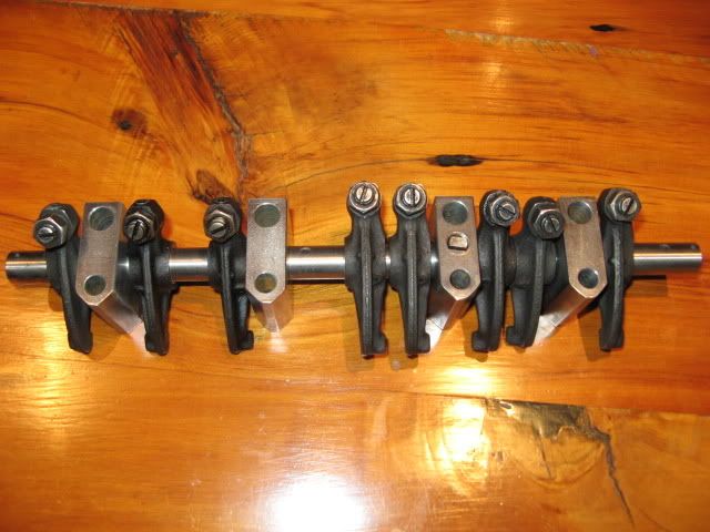

PostPosted: Sat Dec 20, 2008 8:52 am
Posts: 39752
Getting back to Rupert's original post about Corolla rockers, he said you can simply turn the original rocker posts around then redrill the small hole (to 10.0mm) to fit over the head studs.
This is true, but with the following provisos-
1.
They must be the early type CAST IRON posts with both ends radiused.
2.
They then need the front face machined severely to clear the springs.
Note the earlier alloy ones are too weak, they will collapse before you get 40lb/ft torque on the head nuts and give gasket leaks.
Here's pics of a set of alloy ones I fixed up- the PO made them, but the springs and caps were chewing up the posts (because he never filed enough off them) so I milled them to just clear.
Pretty flimsy with that big old head stud hole there, eh.. and the back end where the headstud is is now too thin.
When we bolted these back on the S head, we could not even get 40lb/ft on the head nuts, when we took them of you could see the alloy post was being compressed by the load... :shock: The alloy posts are rubbish.
So, it is now getting a set of the later style sintered/iron posts- I bronze weld steel plugs in, then bore them offset to move the shaft back 4.0mm.
Like these-
