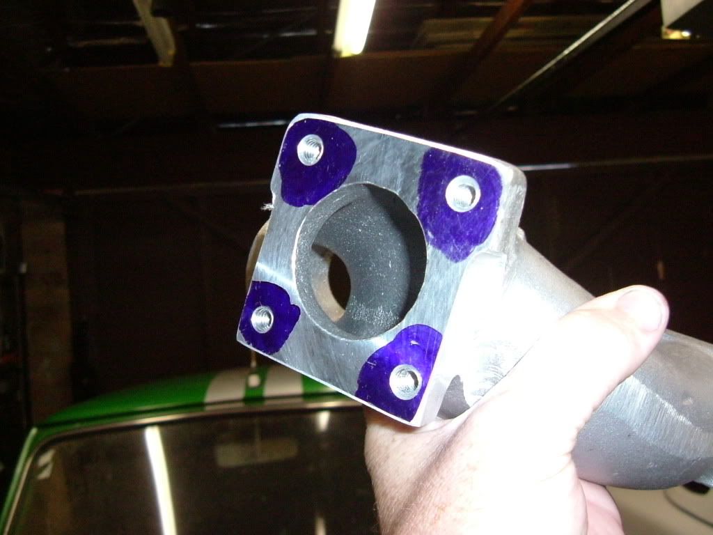

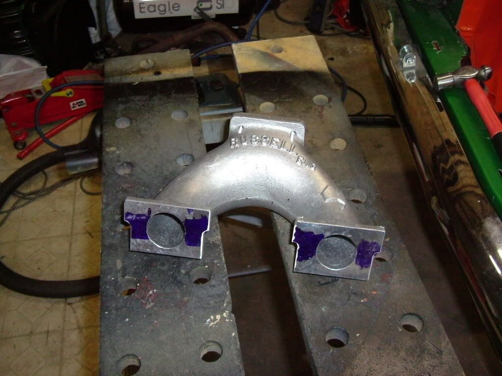

Thanks Matt, I can't wait either... :D , I've got the subframe in and the new steering rack in and you won't believe it but I finally got my manifold from GR's 8) 8) :D :D , I'll post some pics tomorrow.

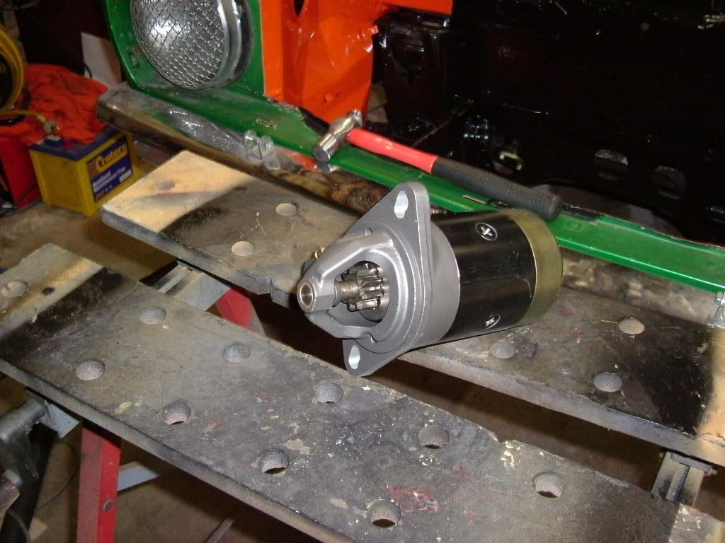

Allright, here we go, sorry for taking so long to update, but I have been busy,(thats my excuse and I'm sticking to it :wink: ). Anyway subframe is in and the new steering rack, the reco'ed brakes should be on this weekend, the big news as far as I'm concerned was that GR had finished my manifold... 8) :lol:, I'm hopeing to get stuck into the wirering this weekend also. Graeme said that next weekend or the one after should be ok for my motor to be dyno'd, and then it's just a mater of dropping it in..yah :lol:
Oh, and BTW here's my new pre-engaged starter

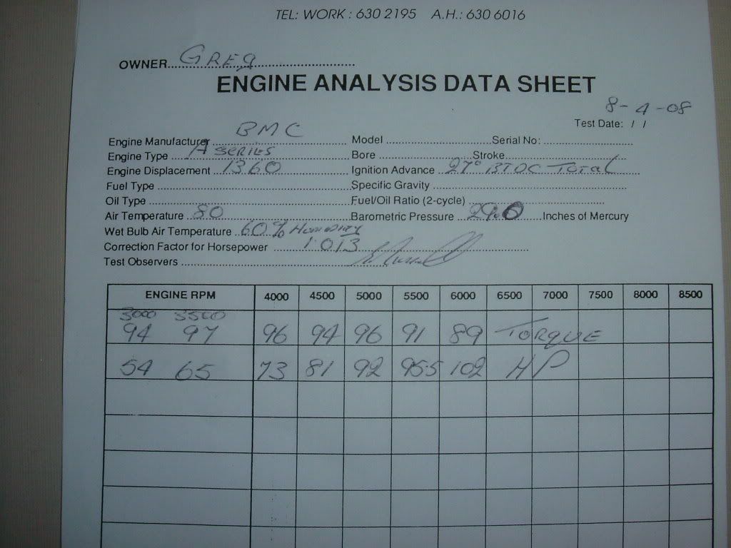

Gerg put it on Graham Russell's dyno today, here are a few pics-
I left early, I'm sure Gerg will fill us in with the number details... :lol:

Ok, it's finally dyno'ed and I must say I'm wrapped.. :lol:, after a bit of a rush to put all the bits on the motor this morning,(due to GR pushing the dyno date forward a day), the motor turned out to better than I expected.
Graeme was very happy with the results and was determinded to get over the 100hp , I didn't leave untill nearly 6pm!!, but at the end 102hp with a standard head is great. 8) :D . A big thanks to Kev and Jim for there help and moral support, to bad they had to leave before the big run. :wink: :D .
