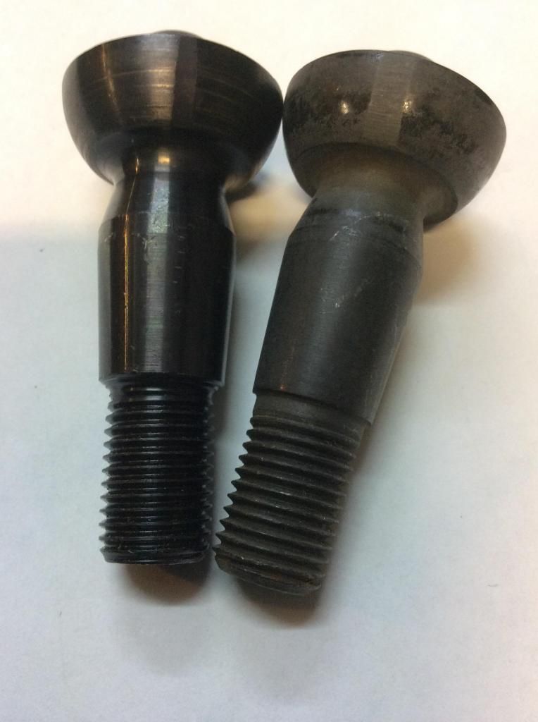

Hi all
After reading the comments about ball joints I took one of my new ones to John's this afternoon for comparison.
The one on the left is my NEW and the one on the right is one of Johns.
I then rubbed both of them around in a ball joint nut.
The left hand NEW one was not smooth in operation and you can see that it only only polished the tops of the machining which is not particularly smooth.
The one on the right has a far better finish and polished up over a large area and felt very smooth in operation.
If your after ball joints I would recommend giving John a call. He was really helpful to me today.
