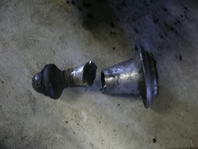

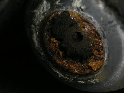

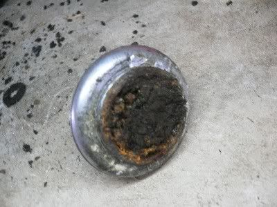

I'm in the middle of replacing my rubber cones...the thread in the old ones was all rusted away and i had to cut the trumpet in half to get it out, not so hard..but now I can't for the life of me get the old rubber cone out!!

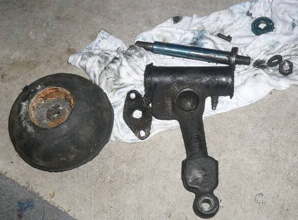

Hehe, felt good cutting up those trumpets :P ...wish I could burn the cones safely :lol: :twisted:
Still on side 1 :lol:
I got the top arm out, fairly easily....for some reason one of the nuts on the shaft retaining plate was a different size to the bolt head which threw me off :?
Heres a look without the arm 8)
Once the arm was out the cone came out with the greatest of ease, almost literally dropped out the hole :mrgreen:
Here's all the bits and pieces out...check out the grease..it's BLUE :lol:

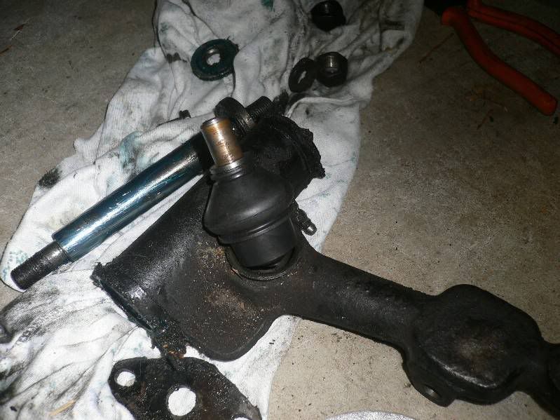

And another shot with the new knuckle..
I have to remove the old cup thing that's in there at the moment right?
PostPosted: Tue Aug 16, 2005 7:34 pm
Posts: 1753
Location: Leonay nsw
yep, and id clean it too and give it a coat of paint befor you put i t back
every thin that needs fixing on my car get a clean while im fixing it so hopfully one day the hole car will be clean :wink:
