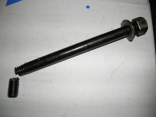

I would also agree with replacing Bolts to Studs..plus your not sure how many times they have already been torqued down before and could break (and this can be a rite pain in the arse) Trust me
The bolts actually have more thread, and protrude into the block further sometimes good if your block has been striped. pros and cons for each.

gafmo wrote:
Sorry when this happens to you
These bolts (only used on Oz motors BTW) are all over 35 years old now. If you MUST use bolts, go buy some new Grade 8 ones.
I flung all mine, went to studs. No more problems. 8)
