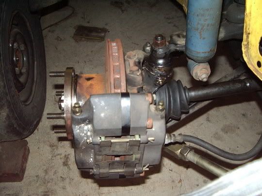

You can try spacing the rotor and calliper back towards the engine. I had to make spacers to fit minispares brakes to my Moke. It has the disc type Sunraysias and they cleared the standard disc brakes but wouldn't clear the 4 pot callipers when using modified metro drive flanges.
I got the 3 mm spacers laser cut. You can just see the big one between the drive flange and disc in this photo. I have donut ones between the hub and calliper.
M
