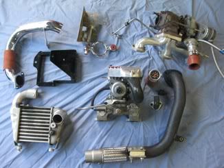

And if you then want to proceed down this path then I just happen to have Metro Turbo kit for sale. :) :)
