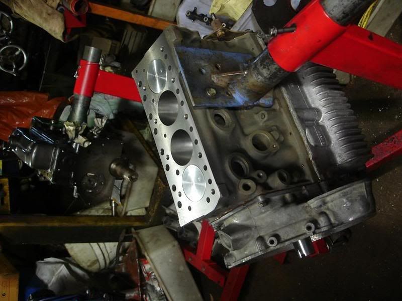

here's what we have started for Morris
1100's block Think it's 20thou so will go only to what we need to
but in saying that...thier seams to be a few marks
All good down here just all oiled up
An the A+ Metro Crank. Orginal Grind & no Cracks
Rods are being Held for me and new Pistons Ring and Bearings
Have a Kent 240 Spider Drive Cam I may put in rather than a RFE13 only as I have one sitting Around.
I have a couple of Flywheels sitting around and back plates..but will also need to get another clutch as ther one in the 1152 is slipping
Carb will stay the same HIF44 again and all the Rest...Pulsar dizzy / Box / will all be the Same as its being driven now
Question thou..as you can see in the first pic..I have (as you would expect from me) played with the wire wheel in a section..What do they look like when they have been dipped "I have a cunning plan, My Lord"

Looking good mate, did you get the crank done at Spiro's?, i'll have to get mine done although I think thats the guy that GR uses so he'll prob be doing it. Your plans of only going out to the next size in the bore might not happen looking at the marks in the bore, I hope they are not to deep mate :( , worst comes to worst you might have to go 1360 or 1380 8) . By the way nice shiny parts look more bling when the block is painted gloss black,IMO...

PostPosted: Mon Sep 10, 2007 8:00 pm
yer haddent notice the marks before and are on the fron side of the bore which is a littl confusing..so I think the 20thou want be enought also...I'll leave that up to GR
