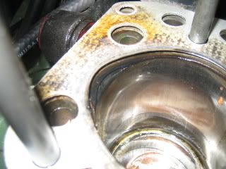

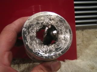

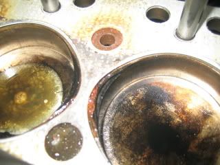

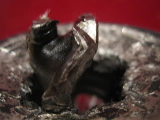

I found my 'trophy' of what can happen when a 998 block isn't pocketed, runs large valves & large cam lift.... :shock: (Have a broken rocker somewhere as well!)
Also have a shot of how my block has been cut out. These are shown with the 998 gasket on. As u can see doc, they are not right out to the gasket line... Will check clearance when i get the head. Will still try to get exhaust valves recessed.

PostPosted: Sat Jul 07, 2007 8:00 pm
Posts: 39753
kazjim had continual sealing problems with his 202 head on the 998 turbo at 12psi or more, that's why we built a 12G1316 head when he upsized it to 1152cc. The deck thickness of 1275 heads is way more than any smallbore one.
