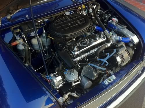

Getting rid of all that won't have any dramatic effects on anything. Just swap the tank cap to a breathable one if you do and block off the connection at the top of the tank.
Other things you can do to 'clean up' the engine compartment:
1. remote mount booster under the drivers guard.
2. Relocate engine computer
3. Change stock air box to a K&N pod filter.
4. Relocate coil pack...... to somewhere (not as easy as it sounds cause the plugs are non-standard).
Having ditched your AC, you could also consider more extreme options like lowering the alternator, or a front mount radiator.
Here's my engine compartment - same year as yours:
