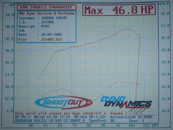

I can't provide you one of similar spec, but this is a graph of my 1152cc with an RE-13 may give you an idea of the power curve, none of the runs on the sydney ausmini dyno day had the torque band though.

That's a pretty flat power curve, i never realised it made more than my max power from the beggining haha..

It's deceptive Josh, they have used a different Y axis scale on each of our plots.
