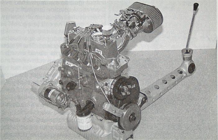

I'm just curious about whats needed to run a mini without the a dizzy in the block?
As per this one in the pic (I don't have the book so I can't read about it)

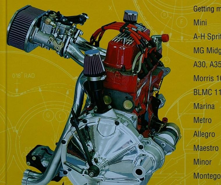

FWIW:
Whether or not that is a coilpack engine in the image on the book I don't know, but I'd say it is not. Coilpack engines have the oil filter where the dizzy sat. Neither are really shown clearly on the cover, but it looks more like a dizzy to me.
:D
Bigger image:

Just to play the smart-ass:
The Vizard engine is a "standart" carb-engine with distributorless ignition system.
(You can divine the crank sensor at height of the "Marina" lettering)

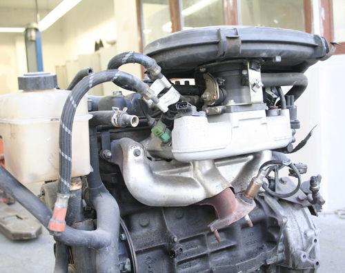

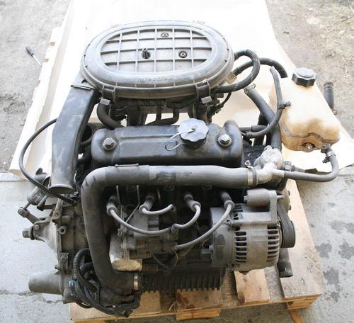

The late Rover MPI engines had an sensor at the flywheel and cam (were previously the mech. fuel pump sat).

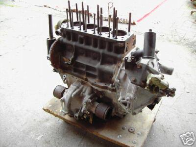

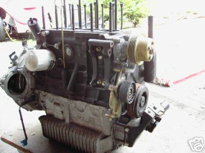

The block & head are different to usual A-Series:
And fully assembled:
Ask "KLAS" - he has some experience in distributorless ignition-system and Mini engines. And with injecting 5 port engines too (hey - even the blokes in England managed to fuel inject A-Series engines :lol: )
