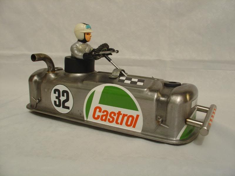

Ray, do you have a rocker cover with the pipe for the breather hose like this?
(but without the wheels or driver)
If you want one, I have one somewhere you can have.

Awdmoke, yes I do have a very small breather connection on the rocker cover but it is only about a 4mm diameter hole in it. Nothing like the rocker cover you've pictured there.

Ray, your cover is off an emissions controlled engine.
The restriction is just at the end. Cut the last centimetre off, or drill it out.
Will help it vent a little better.
