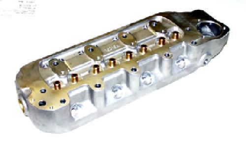

I have just sourced an alloy head. I have read a bit about these and thought that I would give them a try. I got a blank one so i can put bigger valves in. If anyone else has got one of these I would be very interested in seeing the results.

Nice buy....so do you have to put your own valve seats in :?:
I would have thought an alloy "performance" head would come with large valve seats anyway :?:

Mick they do come with valve seats, but if you buy it bare you get no valves etc.
They are made by Pierce in the US, agent here is Redline.

Yeh I got a bare one and will be taking it to a head guy to try and get the biggest valves I can in there.

I have now fitted the engine with the following goodies
- The head as previously mentioned and flowed at 126hp
- The atb diff
- Minisport roller rockers
- 10:1 comp ratio
Have a look at the pictures, over the next few weekends I should have the carbies ready to go.

That head looks great and the flow figure is impressive . Any reason you haven't fitted the extra head studs since the heads drilled for it ?

In relation to the extra head studs, they are not drilled the whole way. My block does not have them so I didnt drill them through.

Looking good. Couple of things to check. Do you know what your compression ratio will be with those combustion chambers? They look a bit bigger than std S which were around 21 cc. Are the pistons flush with the deck?
Also, with the 1.5 rockers, have you checked your valve springs will handle the total lift? You do not want them to be coil bound.
