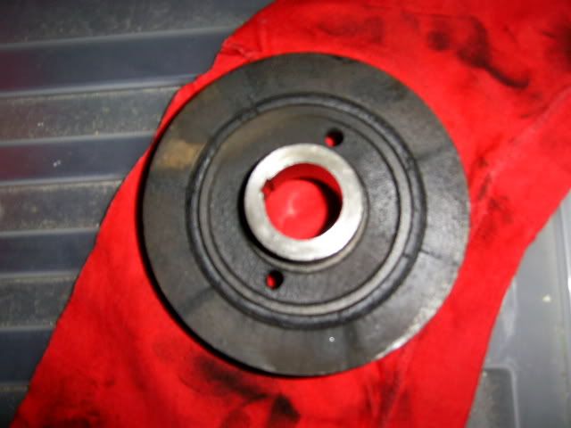

PostPosted: Tue May 19, 2009 1:23 pm
Thanks for the offer Aaron, but the $225 includes delivery to my door.
Just a shame I'm still waiting for it to arrive!
As well as the keyway being flogged, the rubber had axial and circumferential cracks the whole way around.
The woodruff key looks OK (I hope). The crank bolt wasn't tight :x
Engine was built by a reputable builder too.
Can I just ditch the bloody locktab washers and use Locktite Threadlocker or do I still need a washer under the bolt?
