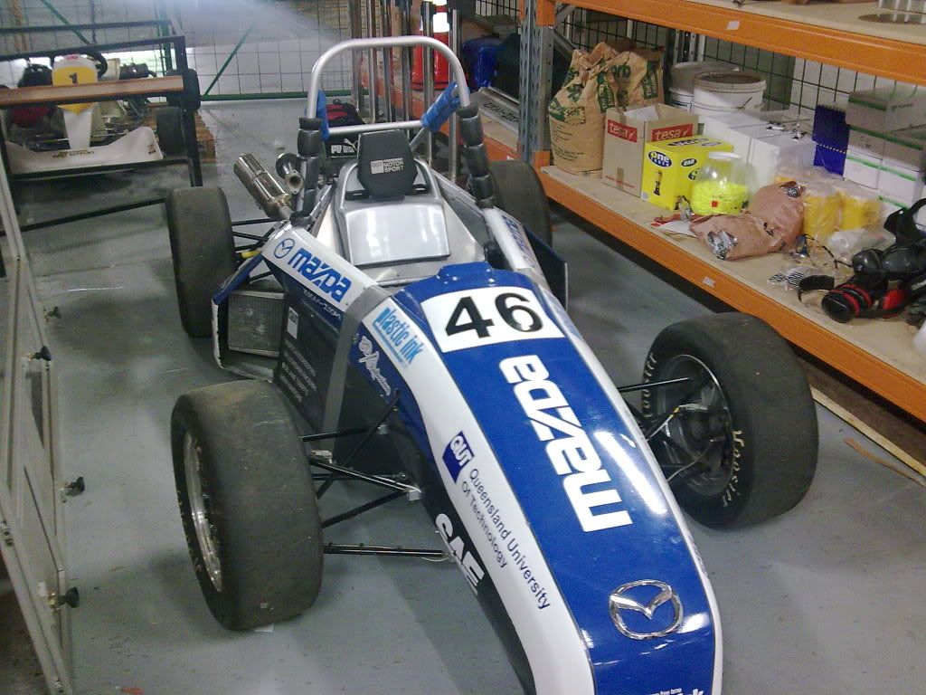

FSAE is Formula: Society of Automotive engineers, its an annual competition between engineering students to make a motorbike powered open wheeler and compete in various competitions. This is the 2007 Queensland University of Technology car:
Sorry about my comment, I misunderstood the topic, i was still talking about inlet manifold length, But agree with what MG Rocket said about air-fuel ratio.
Simplify and add lightness
PostPosted: Sat Aug 08, 2009 5:38 pm
Posts: 3135
blue_deluxe, sounds like a fun project to be involved in.
Mazda obviously don't make bike engines...are they the sponsors of that great looking machine?
