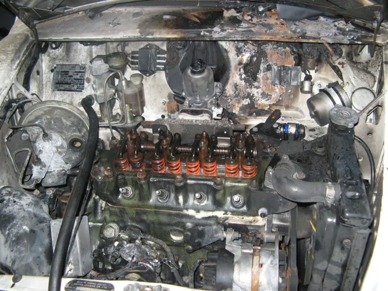

I need to pull my engine down to re do the seals and repaint after the fire so i thought while its apart i would make some improvements.

Fire Pic
