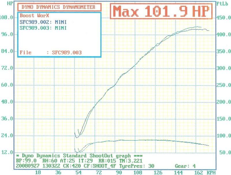

Our 1100 Turbos were making (are making) around 130hp at the wheels.
4-5k will get you started... unless you find bargains.
My suggestion is still turbo - I DONT want to start the SC vs TURBO debate in this thread - but ill make my point - I still have not seen the SC setups making big power for the same $$
I suggest if you want 100hp at the treads, then call Graham, get some pistons that wont break, and start setting up the turbo install. $5k WILL do it... but there are a few things needed that add up.
Chong is right, you make the power then you need to 1. Make it reliably and 2. Get it to the ground. So things like valves, pistons, rockers, gearbox bits for reliability and then LSD, tyres, etc for getting it to the ground...
Then you start making 100 and want more, then you make 110 and want more, then you make 120... and so on lol

This is what we had in our Mk II S. Was really lovely to drive with plenty of power.
Engine - 1330 with Hepolite pistons & rings 60 thou oversize, Kent 731 cam, Kent Vernier timing gear, lightened and balanced, centre main bearing cap, shortened S rods to reduce compression ratio 7:1.
Head - Gas-flowed, ported and polished Mk 2 with Kent springs, bronze valve guides, Rimflo valves, lightened 1.5:1 high lift rocker arms.
G/box - Standard MkII Cooper S, standard clutch plate with heavy duty diaphragm, 3.05:1 diff ratio.
Fuelling - Hi volume solid state electric fuel pump, single 1.75 inch SU carby with water cooled Garret T2 turbo charger running 9psi boost, home-made inlet manifold.
Exhaust - Home-made exhaust manifold and 2.5 inch system with single silencer and centre tailpipe exit.
Ignition - Lumenition electronic ignition, Bosch GT40 coil, 8mm silicon leads, NGK plugs.
Cooling - Hi-volume water pump, 4 core radiator, 13 row oil cooler.
115hp.
