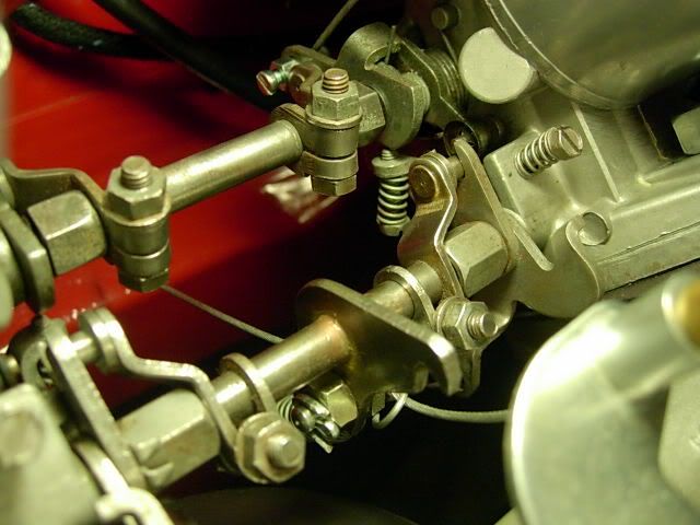

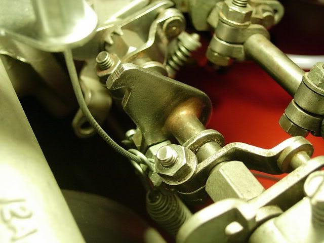

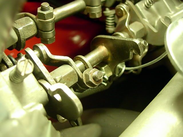

Regarding not having much throttle - please look at these photos as I believe something might be in back to front:

Looks like the throttle shaft is in back-to-front
PostPosted: Sun Nov 29, 2009 10:58 pm
yep,,, Center throttle link is wrong way round
& i`d say you`re sucking air somehwere,,, maybe underneath the manifold, grab a mirror & have a look

Replaced the throttle link with another and now have good pedal range.
