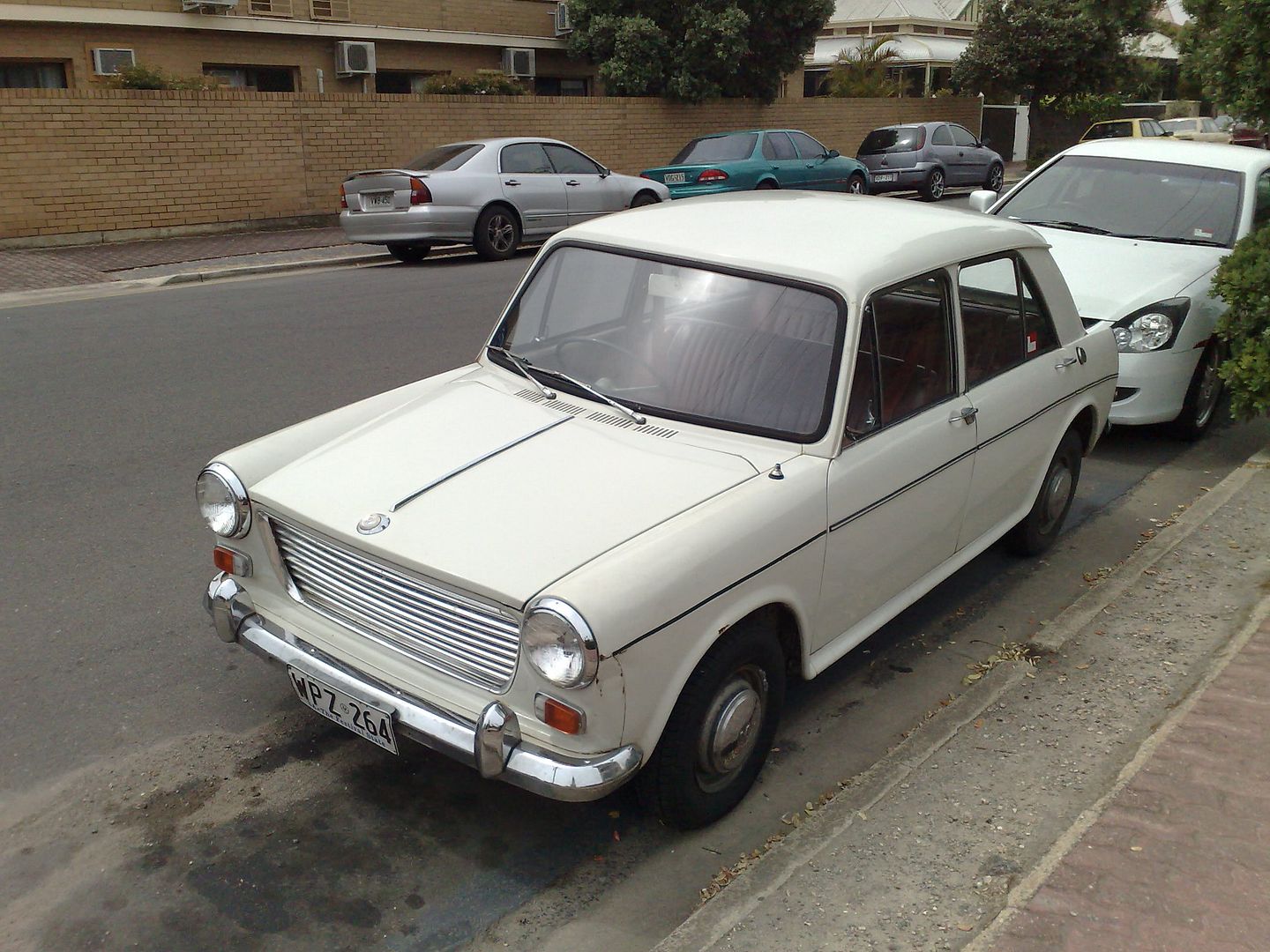

yeah it's not a mini, it's a morris 1100..
http://i189.photobucket.com/albums/z234 ... 008302.jpg
still the same mechanicals though.
