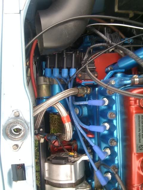

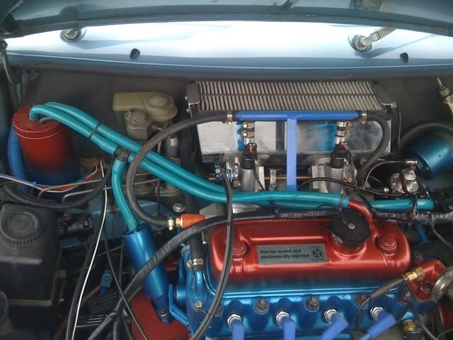

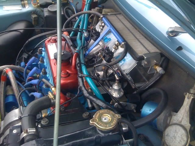

Is this your car? I saw it at Watto's day out. Wish I had taken a few more photos, Very impressive!
Andrew

That's mine! Nice pic. Shows up the airbox well. Bloody Honda filter is great for the job; right size and big surface area, but the damn things are worth over $50 each! Sheesh!

Found a few more pics:
What coils are they? Been looking for some like that, but hard to find some that are readily available at a reasonable price...
Andrew
