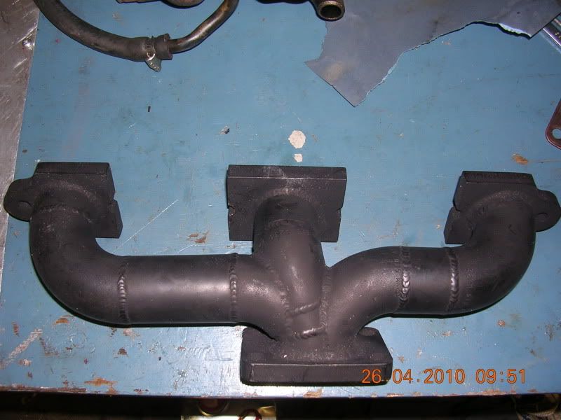

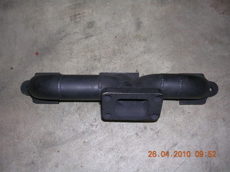

Just thought i would throw up some pics of my new custom turbo manifold.
its a T25 flange and is all but a direct copy of the metro turbo one only flows MUCH better, the std metro one is much smaller ID and has right angles for Cyls 1 and 4 an inch after the gas enters the manifold.
with my new GR cam, this manifold and the SCCR box i wonder how this one will drive (apart from noisey should be awesome)
Grant

How does this fit compared to a standard metty manifold?

Cast Iron Pipe bends? Tigged up ?
Should flow great! :P

graham in aus wrote:
Nice!
Not cast iron Graham, they are steel bends.
Looks a nice job Grant. 8)
PostPosted: Wed Apr 28, 2010 8:13 pm
Posts: 1170
thanks guys,
yes steel steam pipe bends, ill see how it goes in a month or so as i still have a few other sml things i need to finish
