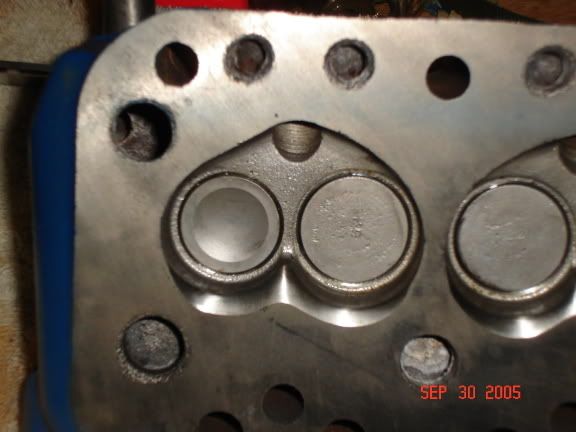

I have a 12G295 sitting here to get checked one day.....but it looks like it was left outside and is likely stuffed. Valve guides looked to be rusted to the casting....bum....
