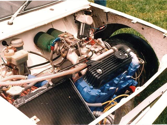

Don't know how useful this is, but this is my Weber-equipped engine room.
As it's my first Mini & I've only had it a week, I can't tell you if the engine has been rotated to make it fit or not, but hopefully some eagle-eyed observer will be able to work it out.
PostPosted: Tue Feb 22, 2011 9:13 pm
This space for rent
Posts: 5455
Doesn't look like it from that pic, those look like bog-standard top engine steadies to these eyes...
Not quite with blue bushes, but I take your point :D
