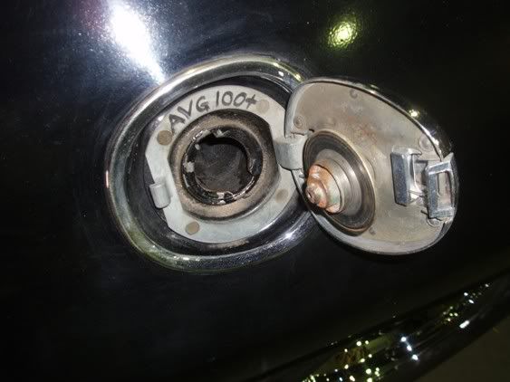

last time a cop ask me if i was running av gas i told him it was caster oil , got away with that one
PostPosted: Mon Apr 08, 2013 11:58 am
Posts: 950
Location: brisvages
never checked the whats under the cap lol
