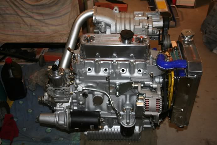

Yes you need to remove the distributor shaft plus plug up the hole
There are a few different plugs available, I think i got mine from an Ausmini member, Ben?
Here is the plug in situ
