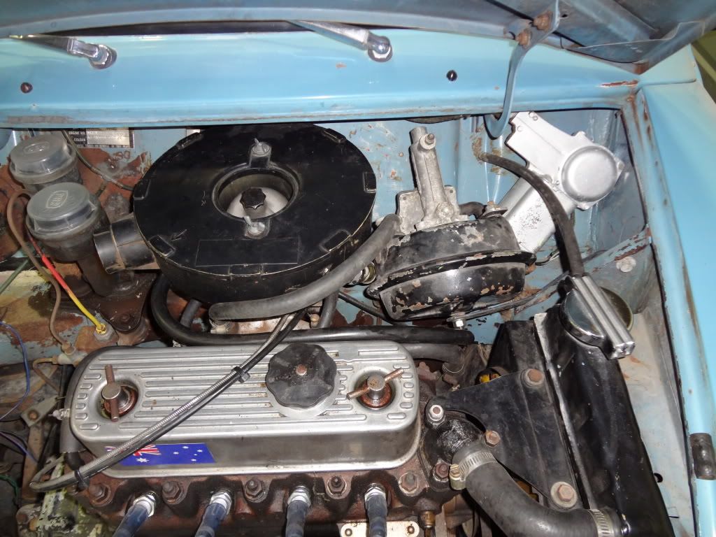

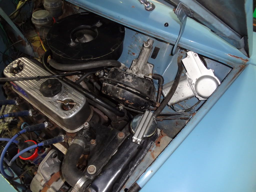

PostPosted: Tue Oct 11, 2011 5:51 pm
Joined: Tue Mar 27, 2007 7:46 pm
Posts: 296
Location: Strathmore, Melbourne, VIC
well i got it mounted the other day.....
Appart from the engine bay being completly ugly anyway i think it fits rather well :)
Just need new lines and a bleed.
What size fittings do i need to get? And will the fittings work with some trailer brake line i have?
'63 850/1100 + more cooper goodies
