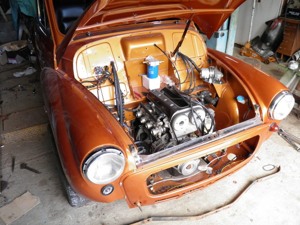

I have done the engine transplant thing on MORRX, injected 6 port 13B and 4 speed auto out of a series 5 RX7 hence the name a mix of MORris and RX 7.

HA! and here's us fantasising about rotary Minors :lol:
