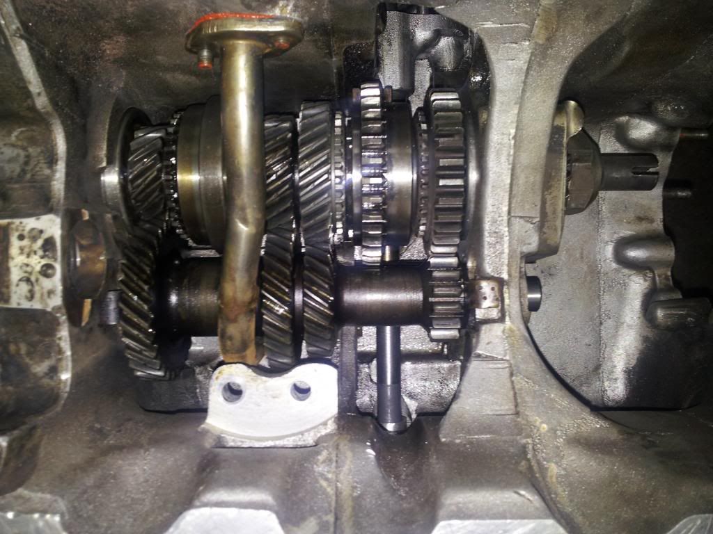

When I was tinkering in the shed, I found the reverse selector and gear controlled the amount of overthrow on both syncro hubs in one direction. Took reverse out and I had more overthrow. I controlled this by putting a “stop” on the rear of the shaft running through the box.
I also removed the pin from the shaft so that I could get it into the box. The selectros hold the pin in place once assembled.

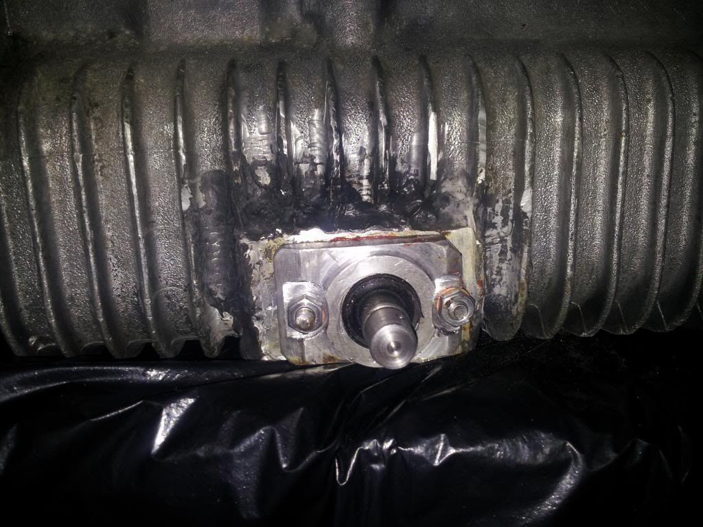

well after a few weeks of stuffing around in the shed this is what we came up with. The shift "feels " fantastic :D

Did you remove the pin from the selector shaft?
If so, do you resecure it in the shaft, or is it just resting there, held in by the selector sleeve?

the extension is stepped in to the end of the original shaft, the shaft is bored to be a press fit, the pin is a tap fit { medium bfh } and then it has a 1/8 hole through the lot with some tie wire just to make sure it won't fall out

We welded a 1/4 alloy plate @ 90 deg to the shift rod onto the front of the gearbox and made a bolt in slug that uses a rod box std rear seal :D if we undo the 2 bolts @ the front we can slide all of the shift rail out through the nose.
