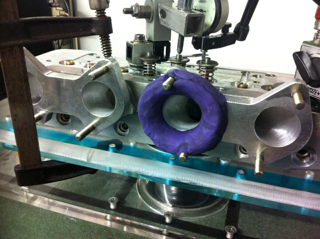

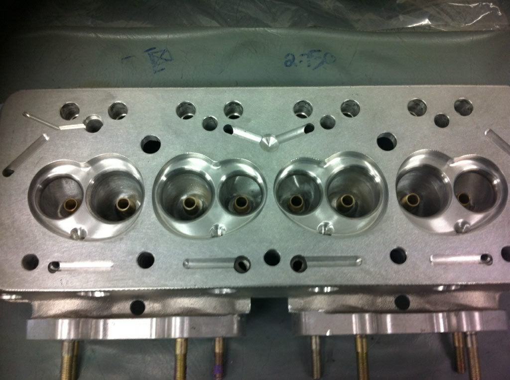

i have played with a few of these now & we are really starting to make some "head-way" :-),,, these are not really the best heads straight out of the box tho... pretty damn yukky actually, & if i were anyone contemplating fitting one of these heads i would seriously look at getting someone to actually fix them & work them a bit before fitting for sure
anywasys, pretty pics of some long hard tiring painfully slow work in progress :-)
PostPosted: Mon Jun 10, 2013 12:23 am
oh & yes Dave M , this is your head, not far off being ready for you :-)

Whats the playdough for?? :-)
Radius entry to the port. If you don't use it you will get a wrong (low) reading of what the port can really flow in practice.
Yeah it`s all a bit of a fudge really,,, the play-doe is needed to make it "sort-of-real" but not quite,,, but if you use the same piece/shape of play-doe for all your testing then we can see any difference in what mods we do to the ports/seats etc & as the play-doe stays the same for all tests yeah?
& yes Pierce head , didn`t quite make 80cfm to start but came up just past 130 at the end , & i reckon we could do more but probly stuff a few heads trying , at least they should be pretty easy to weld back up again :-)

we`re still finding gains,,, but truth is lately i havn`t had much time on the Twinky porting game, but i can tell you that i take some meat out here & there yeah,,, but i also add some meat in some places & have found gains too :-)
