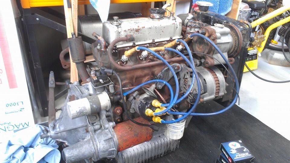

What i started with

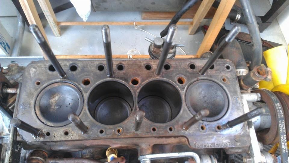

Bores look good

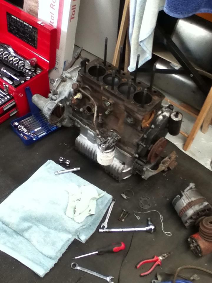

Slowly stripping

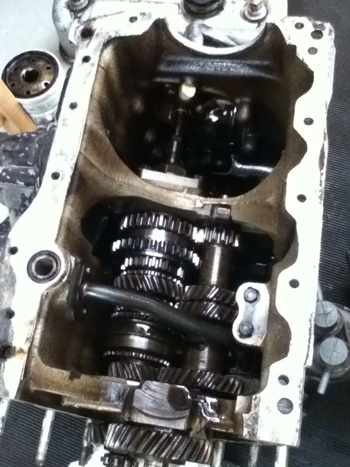

Gearbox looks good

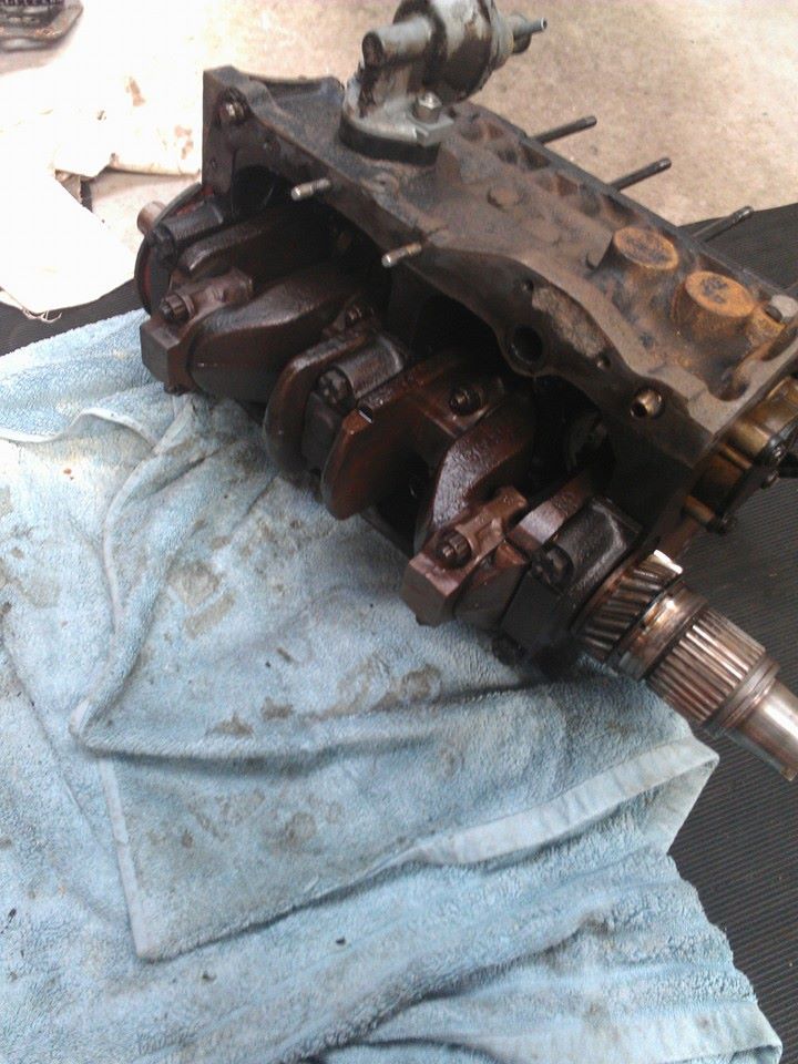

Same with the bottom end

lumpy cams aren't the best idea for forced induction - the lumpiness is there because of overlap, overlap with boost means you're just pumping boost pressure out of the exhaust ports. I like my RE83, mine is the non boost version, but GR does one set up for boost (RE83T)
best distributor is no distributor at all
that's a large journal crank, you could get it stroked, would be lovely with the blower on it
I have GRs pistons in my motor (still on the bench), he's taken the dishes out to 13cc (I think thats what I measured it at) and I've removed the beaks from the head. The head had already had a fair bit taken off the face so cc was low. It makes my C/R about 9.3:1 which I'm happy with. I reckon 8:1 would be really hard to get down to. It'd also be really doughy to drive off boost....
I was running more like 9:8:1 with my old pistons and they survived really well considering the 30,000km of abuse I gave them. They were hypatecs, one had melted a bit from running too lean, and all of the rings had lost their tension which GR says is a problem with the hastings rings, as soon as they get too hot they go floppy.

I've built my motor to be 9:1 compression. It's a 1330 and the pistons are sitting just proud of the deck. My choices to lower the compression was to either machine the pistons, run a decompression plate and 2 gaskets or open up the cylinder head chambers. I decided to open up the chambers, which was a lot of work to go from 21cc to 30cc but i think it's the better way to go.

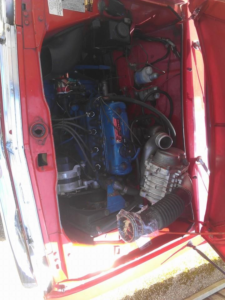

Ok there's been a bit of a set back.
I'm glad I haven't ordered the sc12 kit yet as it turns out the guy that had mine didn't realise it was actually an sc14.. :shock:
Partially my fault because I didn't realise at first and now have. :oops:
So unless anyone has an sc12 they want to swap for a 14 I won't be supercharging anytime soon.
Cheers, Rhys

I was wondering about that - looked a bit too big but I thought maybe it was just the photo

No problems.
All back on track.
Sc14 sold within 20 minutes of advertising it. Being picked up tomorrow.
And already got my hands on a full sc12 kit and sc12 minus the engine steady.
So I will need an engine steady to suit the sc12.
