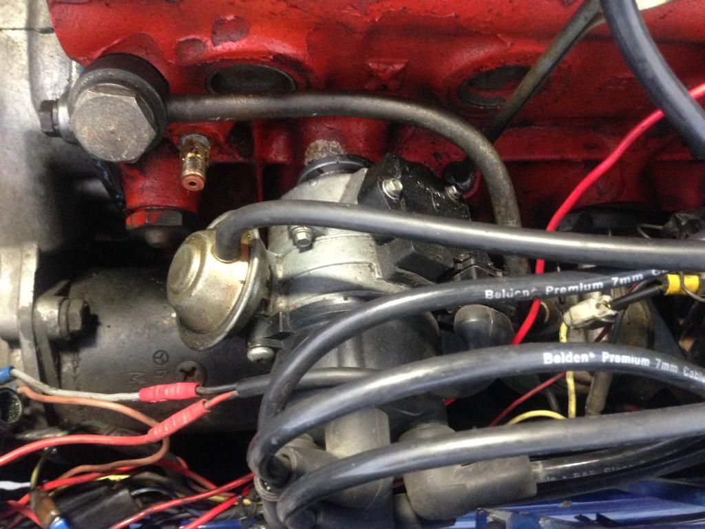

Electronic.. Poor pic but but can double check model tonight.. Its a 1275 from I think 89" metro
